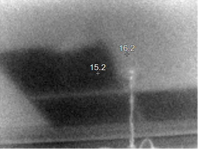

                      Find someone with a thermal imaging camera and turn it on at night and see if it starts warming up. You should be able to see the path of the heating elements. Thermal cameras are becoming very common now, even home depot carries them. Some attach to the bottom of your phone/tablet.
                      • #26
                        Agree with macona. A thermal camera, especially one designed for building inspections should show you where all the working elements are. Industrial cameras have a wider temperature range, but are normally less sensitive.
                        The two markers in the image below are only one degree Celsius apart (1.8 Fahrenheit). The dark patch is missing roof insulation.

                            The thermal camera idea WOULD find a dead section, if there is one, and confirm all the sections are still working, core or no core.
