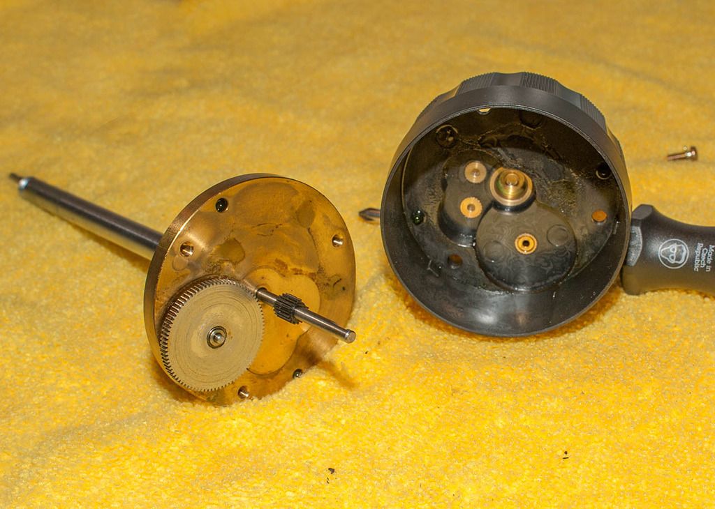

    I know absolutely nothing about gears. Anyone know where I can find one of these and/or what do I have to know to start searching. It's operates the fine focus on a Nikon MM-11 toolmakers microscope. The focus block moves 200 micrometers (aka microns), or 0.2mm, per fine focus knob turn. The measurements are approximately; bore .118", the diameter .237" and length .268".

              This is a pretty standard size in a clock. Check those suppliers. Most (non-hobby) clock repairers don't make their own pinions so there should be sources.

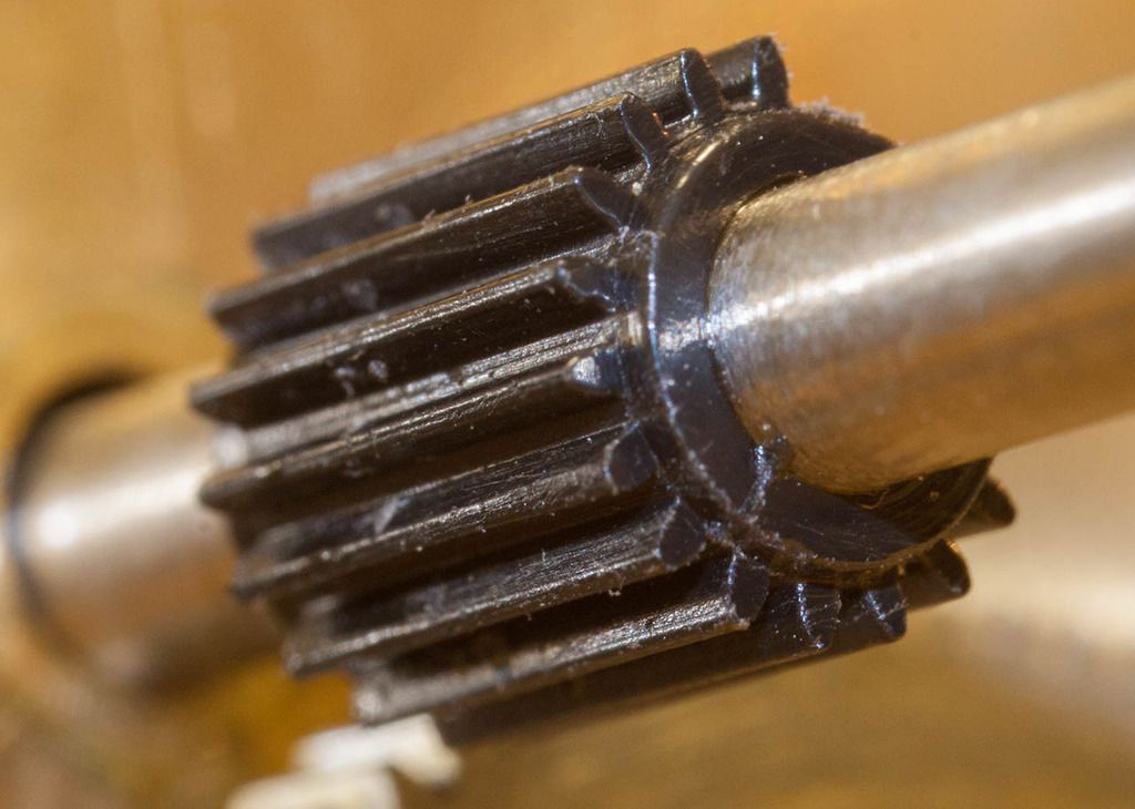

                Judging by the rough finish on the gear, I don't think it is a high precision component. And it appears to be molded in place on that shaft or perhaps molded and then pressed on which would require an exact size hole to fit properly.
                There is an old trick for making a replacement gear. You take a strip of thin sheet metal and form it into a rack shape by meshing the gears with it between them. In this case I think we are talking about aluminum foil to get it thin enough. Cut a strip the width of the gear. You have enough of the original gear left to make about 3/4 of what you need and then shift it to make the rest. Probably good to overlap one tooth so it locks the ring together.
                Press the old gear off. Try not to harm it as you may have to do this a second time, or even a third. Add some side plates (washers?) as you put it in place on the shaft. Pour some good epoxy, perhaps with some reinforcement media added to it (chopped fiberglass?) and let it harden. Bingo, new gear.
                Centering will be a problem. You may have to make a special step washer to fit the shaft on one end and the OD of the gear on the other.

                  Yes, this is right on the money. Specifically, search for "pinion wire", it's what is typically used. It's formed into pinion leaves the entire length, and you cut/machine to suit your application.

                        They don't make pinion wire in 18 teeth module 0,3 drilled at 3mm to my knowledge. In any case someone sent me a link to a fellow on eBay that remanufactures this particular gear.

                          The gear appears to be module 0.3, 18 tooth, 3 mm bore, which is equivalent to 84.6 DP
