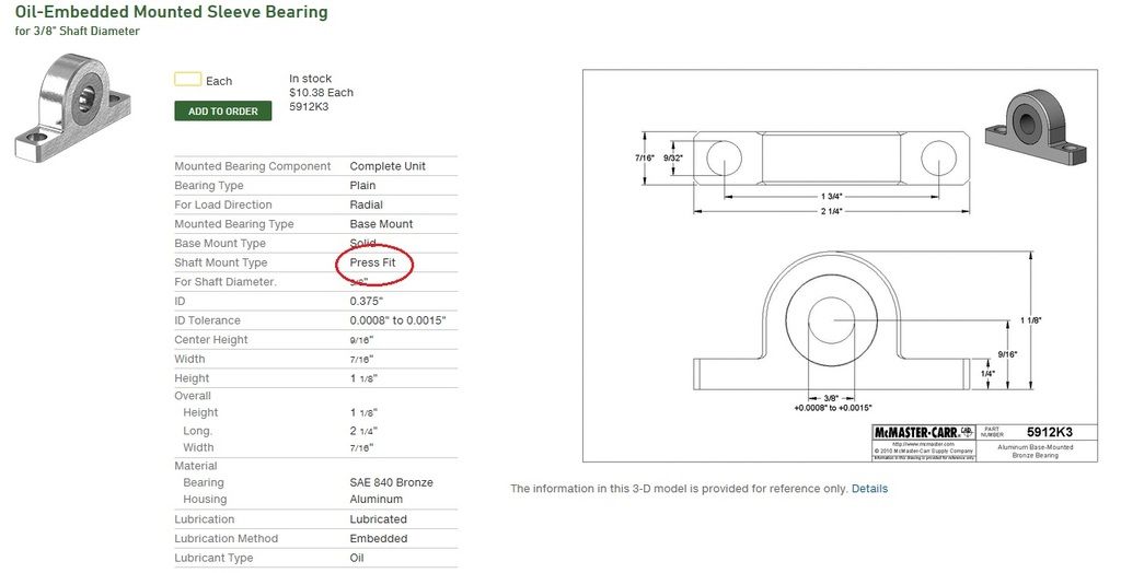

                      Original poster here.
                      Thanks for the discussion everyone.
                      I posted a description of the bearing in question below.
                      [IMG][/IMG]
                      As you see it clearly states "press fit", but I'm holding the bearing in my hand, and that inner sleeve is not free to spin.
                      Consequently, it seems to me, if I turn the shaft diameter to be a press fit, the shaft will basically be seized in the sleeve, which appears to be "fixed" to the housing.
                      In which case it seems like it should be a slip fit, more like the babitt bearings around an automobile crankshaft, and not a press fit.
                      Please advise. And be gentle, I'm not knowledgable on such things.
                        I believe that the 'press fit' spec means that the bushing is a press fit into the aluminum frame. The drawing indicates that the bore, as delivered to you, should be 0.0008" to 0.0015" larger then 3/8" (stupid mixed fraction and decimal....), or between 0.3758" and 0.3765"
                          That does seem strange....agree with enl. Mistake by McMaster? I'd want to see the manufacturers info before taking it as the gospel.
                          btw, pillow blocks like that can be difficult to work with in that its hard to achieve perfect alignment. That means the shaft is fighting itself and bearings - binding. The solution is self aligning bearings - they're the thing to use when you don't have a lot of a control and precision on the mounting.
                          Bunting and maybe others makes self alignment sintered plain bearings - either as inserts or pillow blocks
                          see page 227-229

                              I believe the press fit in the chart was an error by the chart maker. Either through ignorance or inattention. The ID tolerances below that would be the right amount for a clearance or slip fit. JTiers above has a good summary in the post above.
