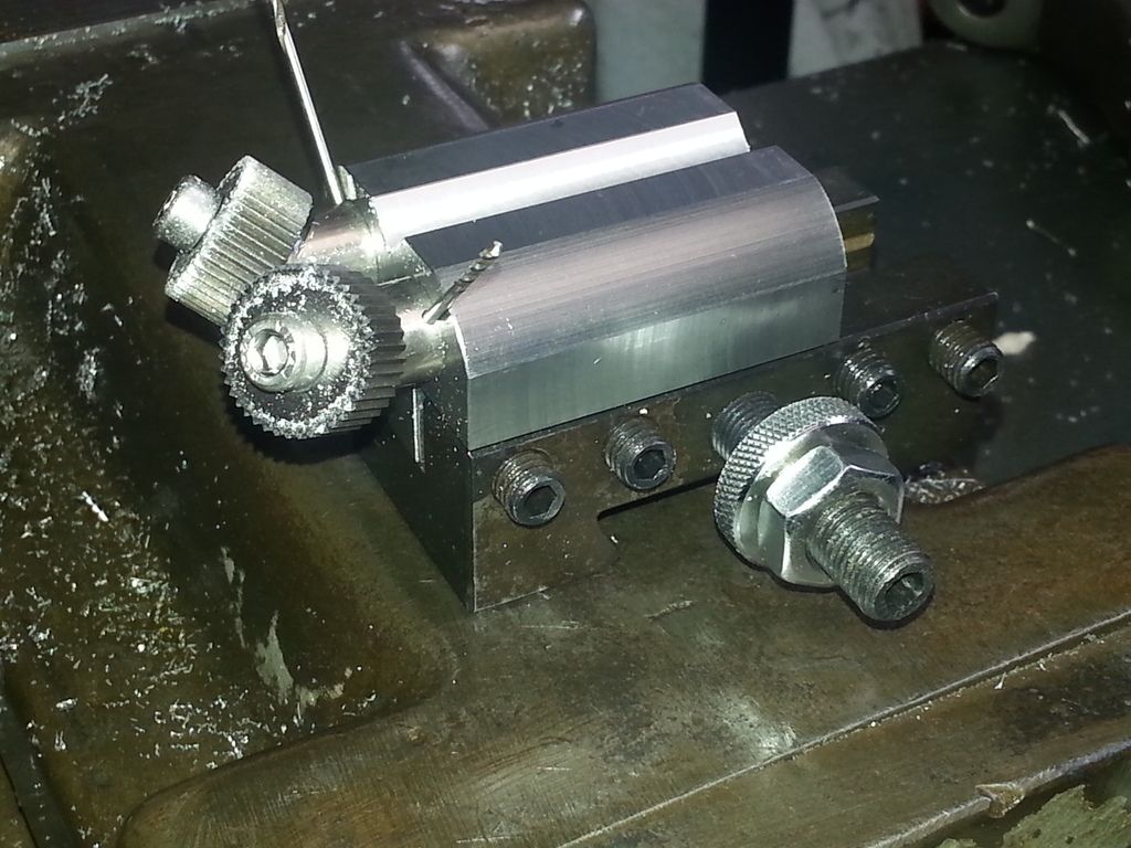

                      I like a clamp and/or scissor type knurler for small items and made a cut knurler for bigger items, IMHO the cut knurler is more fiddly to setup but then that could be down to my shop made versions idiosyncrasies.
                      For smaller parts I prefer this one which is a larger shop made copy of Hemingway's knurling tool.
