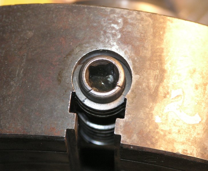

    A 6" Burnerd 4-Jaw Independent Iron Body Chuck - Series 34 has one operating screw that is cracked.
    The cracks are visible at two of four corners of the broached square wrench socket. They extend from the lip of the mouth down to a depth of one thread. Either it was a simple matter of too much torque applied or maybe the chuck wrench was not fully inserted. Perhaps someone tried to remove the chuck by smacking the wrench.
    The screw turns easily in the chuck and I have been using the chuck as is since it arrived here, taking care to tighten the other screws against this cracked one. While cleaning today, I wondered about repair.
    The operating screws on this chuck appear to be staked in place - I have not studied this closely, but I will assume that the stake can be removed. Replacement of the screw seems to be hampered by a lack of a ready source for another one. A repair of the hardened and ground screw seems limited to shrinking a collar over the lip at the mouth and I do not think this would gain much.
    Any other ideas?

      The Burnerd looks a little different. There appear to be pressed-in-place slugs.
      Underneath these slugs within the body of the chuck, a U-shaped yoke engages 180؛ of a necked-down section of the operating screw. I do not know whether the yoke is a separate component or machined on the inner end of the slug, I expect the former.
      Although the appearance mumurs "No user-serviceable parts within", drilling/tapping might enable the slug to be extracted - if indeed a pressed fit.

          The collar at the end is usually very close in size to the minor diameter of the thread. So I don't think a collar of any usable thickness is a realistic option.
          I'd be leaning towards TIG welding the cracks at the collar and down onto the last thread. And if possible from the inside a short ways into the square recess as well. Done with a light touch and not much time on the joint and a cool down between welding the cracks should provide enough of a repair that thoughtful tightening of the jaw should be possible for years to come.
          In terms of affecting the heat treatment of the screw with care and a fairly rapid on then off for each crack the softening from over heating of the metal should be able to be limited to just the weld and the last thread.

            I see the two cracks you mention at 4 and 7 o'clock. It looks like there is another crack starting to form at 2 o'clock.

              I have a couple of Burnerd 4 jaws like yours which have no locating screw holding the retainer, in my experience they are a slight interference fit, looking from the front you will see a small shoulder sticking up either side of the operating screw using a suitable punch a few alternating taps on these shoulders should see the retainer out.

                I have knocked those retainers out from the front with a forked punch.
                  same as Paul ^. Once you remove the jaw, you should see a bit of metal on either side of the groove in the screw. These are 2 "prongs" which are part of the plug on the back of the chuck. You can either do as Paul and I did and gently tap the plug out with a punch or drift or you can make a special prong like tool to press on both sides at the same time. Mark the plug and the hole if you're doing more than one. I took my 4 jaw Buck chuck apart to clean out what looked like decades of plastic powder, it was very straightforward.
                  Personally, for the effort involved in fixing that one, I'd just make a new one. PStechpaul did a nice job on his on here, seemed pretty routine as long as you can grind an Acme (square?) thread cutting tool. Don't know if the threads are LH or RH, which might affect your ability to make a new one. Some nice 4140ph and you're good
                    Pratt Burnerd chucks over 4" generally have a circular plug with a forked end for each jaw, it's a light press fit and can easily be driven out from the front, the forks are not hard so use a brass drift. Jaw screws for Imperial chucks are no longer available from the makers. There are at least 2 different sizes of screws for 6" chucks, maybe also for others, check size carefully if buying used or NOS replacements. Dave

                      Assuming that this is hardened high carbon/alloy steel part I would be more worried of getting glass hard welds than softening the screw. If going the TIG welding route preheat to 200-300 celsius weld after that.
                      Small tacks and short TIG welds on hardening steel like 1045 without preheat barely hold together the parts in slightest breeze, the weld has strenght of dry cookie.

                          Leave the cracks alone.
                          Shrink a sleeve over the spigot
                          to contain the hoop stress
                          and it will keep the cracks tight.
                          No need to even take the screw out.

                              Yep, Doozer ( and others) got it right. I would shrink a collar of 4140 on the cracked screw AND the rest of them for good measure. Good luck.
