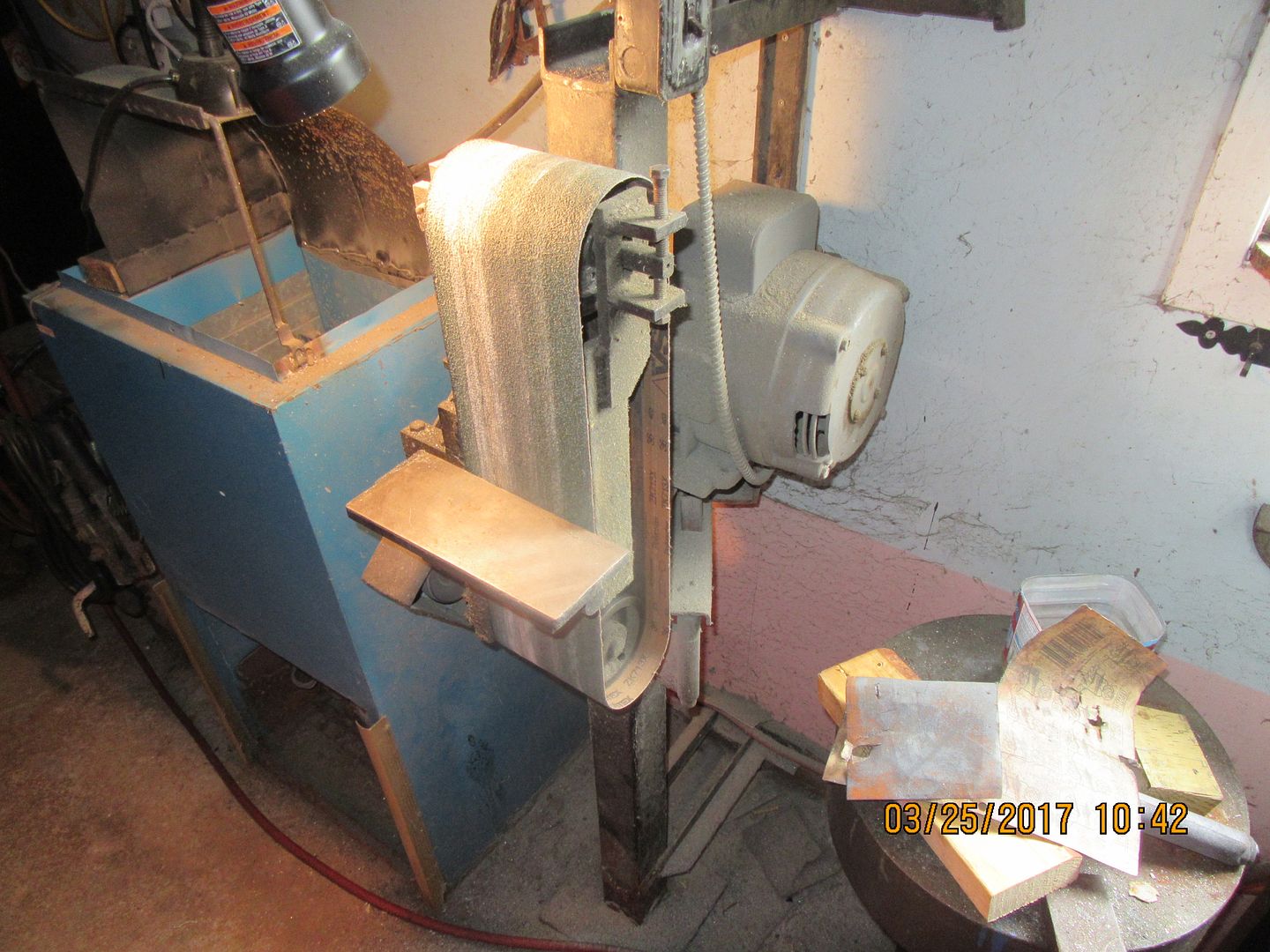

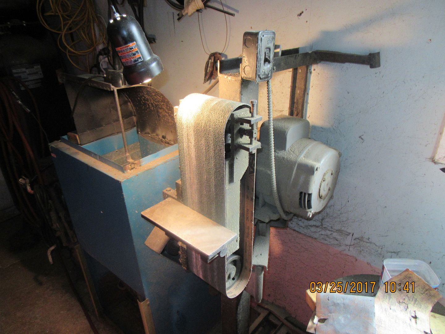

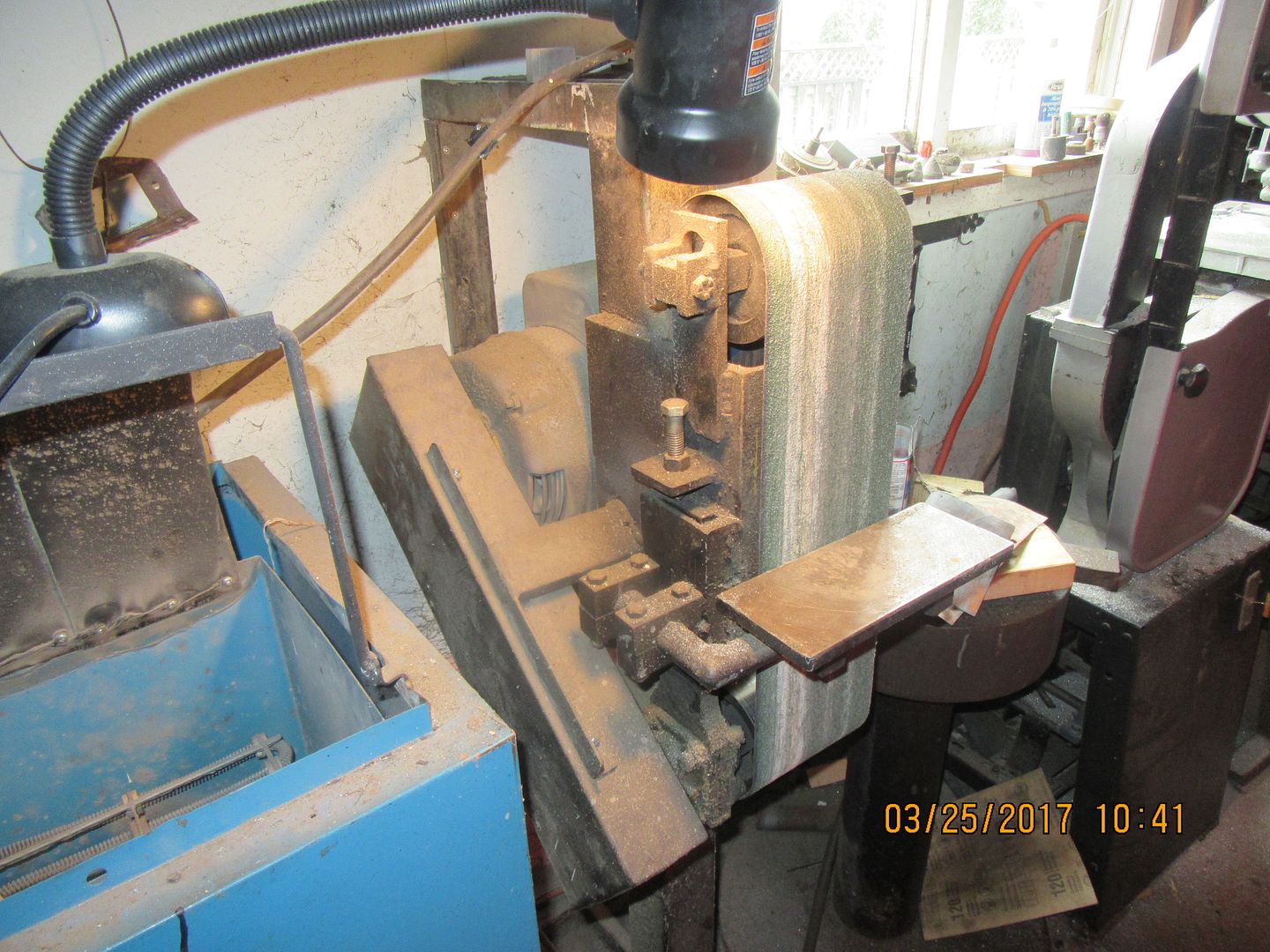

          I get the idea that you are looking for plans for a serious belt grinder like mine. I built this many years ago. It has a two horsepower motor on this one, and when I turn it on all the lights in Barrie go dim until it is up to speed. I don't have any plans now, but you might pick up a few hints from these pictures. One thing I would change if I ever built another--Don't use a v-belt drive from the motor to the powered roller. It eats up too much horsepower. Put the drive pulley right on the output shaft of the motor, or use a Lovejoy style coupling between the motor output shaft and the powered roller shaft.---Brian
                Thank you Brian!
                The top roller adjusts both tension and tracking?
                Oh, no...wait, I see something going on at the left side.
                Yes I see the tension adjuster now.
                Len
                • #38
                  I see the tracking adjustment at the top wheel. And I see what looks like a tension adjusting bolt on the left side. Is there any provision for a quick release and belt change?

                      There is no quick release. You loosen off the adjusting bolt on the left side and that lets the bottom roller, shaft, bearings and support slide up to change the belt. The rollers that the belt roll on are mild steel. Belt never slips, and lasts one to two years.--I see absolutely no reason to go to plastic or rubberized wheels. The wheels on the sander in the picture are 4 1/2" solid steel. It takes a lot to get the sander up to speed because of the weight of the pulleys.--If I was making it again I would make the pulleys from aluminum or from steel pipe with 3/16" wall and welded in endplates. -Brian
                      Design engineer
                      Barrie, Ontario, Canada

                          That is an excellent design of a belt sander. If I was to make another, that is almost exactly what I would do.----Brian
