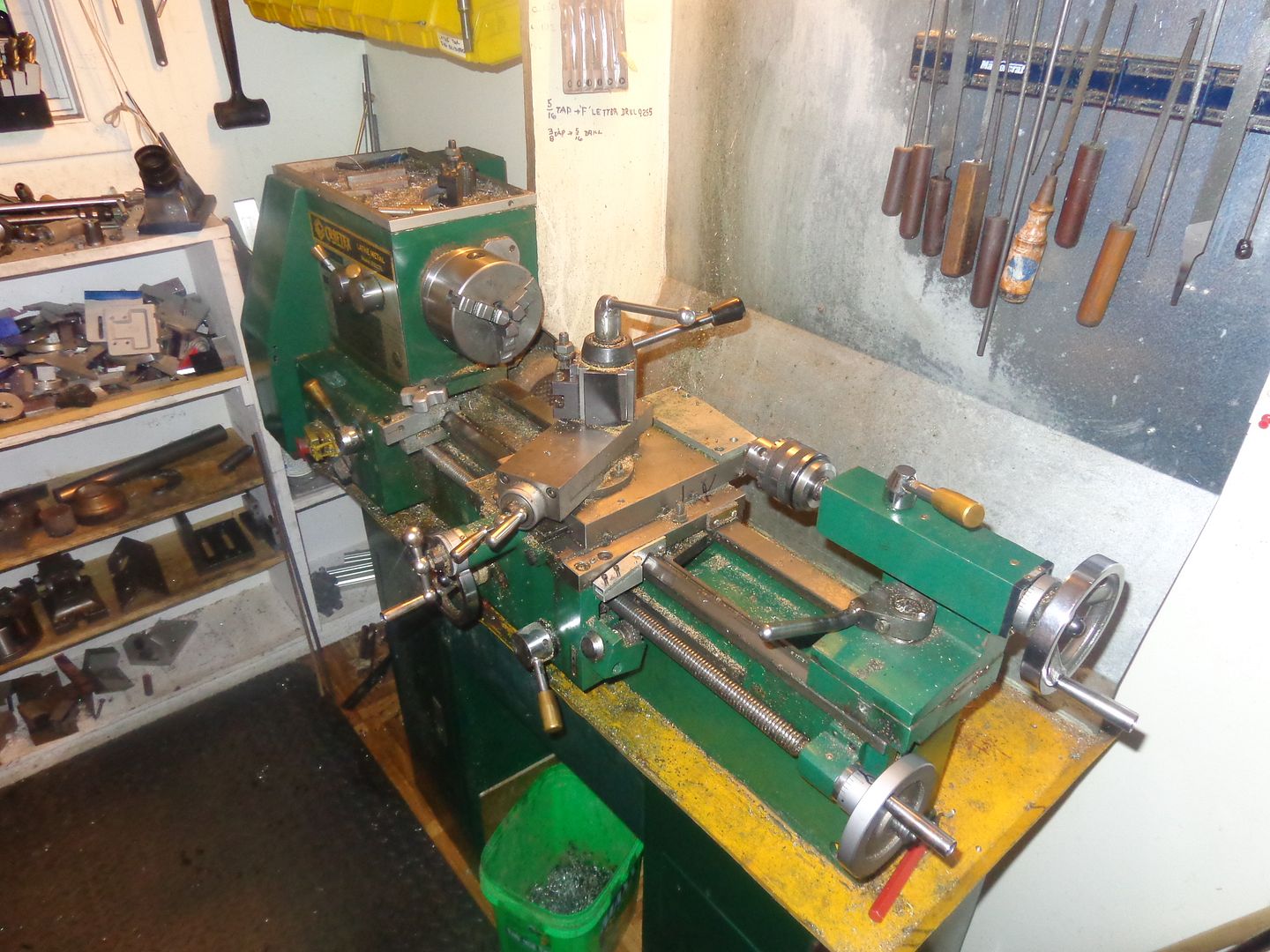

                      If you have never had a lathe with a handwheel on the right hand end to turn the leadscrew, then you shouldn't be running your mouth about what a terrible idea it is. I found it to be just about one of the handiest features on the lathe.----Brian

                            I wouldn't have wanted one on a lathe with a 30" or 48" carriage. However that lathe in the picture was a 10 x 18" lathe, and I found it to be just fine. I never noticed that it was particularly slow. If I wanted to move the carriage any large amount, I just disengaged the power to the leadscrew (it had a lever for that) and moved it with the big wheel on the front of the apron. So much of the machining I do was short lengths that were best accomplished with that handle on the right hand end. That old green lathe, like my new lathe had a very coarse feed on the apron wheel. It was just awful getting any accuracy of movement with the wheel on the apron.
