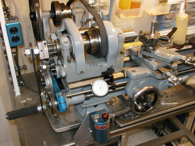

    The use of an uncalibrated hand wheel for moving the carriage is not completely a bad thing. I have a small lathe, a Unimat, and it only has a hand wheel to move the carriage. The carriage movement is only about 150 mm or 6 inches, but at 1 mm per revolution, it takes a bit of time to move it from one end to the other. The hand wheel on my SB-9 if a lot faster for rapid transverse than any hand wheel would be.
    Another common solution to this situation is to mount a DI on the ways where it can measure the carriage movement. I have a 2" one for my SB-9 and I find it very helpful. It does not have the range of a DRO, but it does cover at least 90% of the jobs that I do. For longer distances, I would do a rough cut and measure the part. Then zero the DI at that point and remove as much more as the measurement calls for. This works well.
    You can see this 2" DI here.
    I have made a new mount for it since this photo was taken. The one in the photo came with the lathe and was rather shabby and shaky. The one I made is a lot more solid.
    I like to save my lead screw for threading. But sometimes I use it for power feed. I need to upgrade to the SB-9B model.
