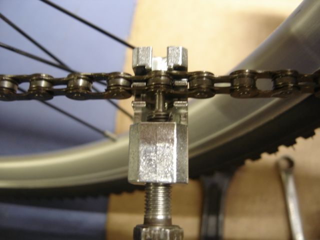

    I bought this bicycle chain repair tool to open up the chain so I could install a new derailleur on my bike. I knew it was probably junk since it only cost $6, as opposed to decent ones that go for $15 and up, but it only needed to work once, and probably never get used again. Also it was available at the local wallyworld. No big surprise, it didn't even make it through one iteration before the push pin broke. Luckily I found a 5/16-24 bolt and whipped up a replacement that worked like a charm, and should last well beyond my time with this bike. Not much of a machining operation, just retapped the metric hole for the sae bolt, ran the thread down to the bolt head, and turned the end down to the pin diameter.

    Good save,some percentage of being a machinist requires the ability to make chicken salad out of chicken s--t

                        You can't replace a chain by simply taking apart derailleur. It has to be 'broken' and fished through frame 99% of the time.
                          Break chain once and use one of these from then on.
