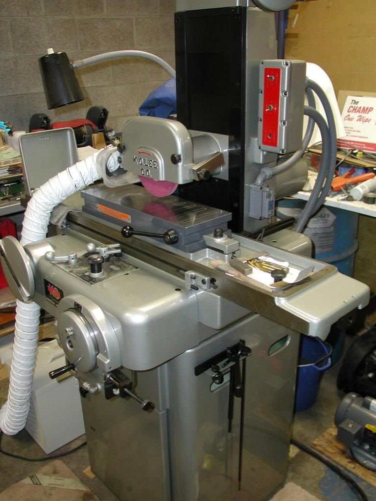

        I simply run a shop vacuum with a long hose connected to the hood mounted on the left side of the SG table. No problems so far. If I ever need to upgrade, I'd go with an ash vacuum cleaner.

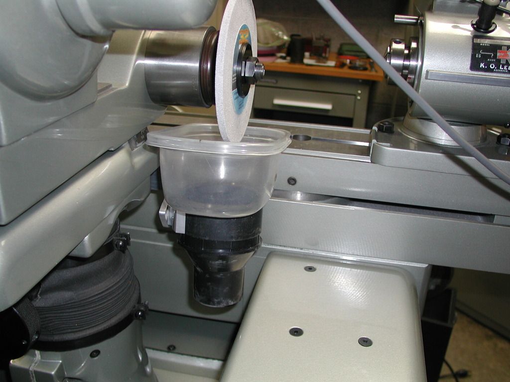

              This is what I rigged up for my grinder. It catches about 90 % of the dust. Grinding isn't the big issue it's dressing the wheel.
              I have a similar setup for my T&C grinder that I'm still working on. The problem there is there isn't much room for the shoot or funnel like there is on the surface grinder. If I re-position the head then I have to re-position the collection shoot and there isn't any room to play.

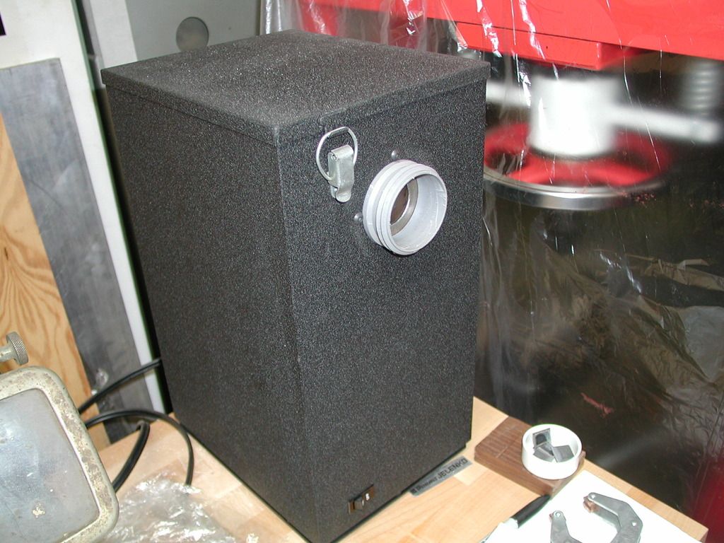

                        This is the dust collector vacuum unit that I use on my SG. It's not really a vacuum, it doesn't have much pull. I think it originally was one of those tings that the nail salons use to wisk away the smell of the nail polish and nail filings, Ha, Ha.

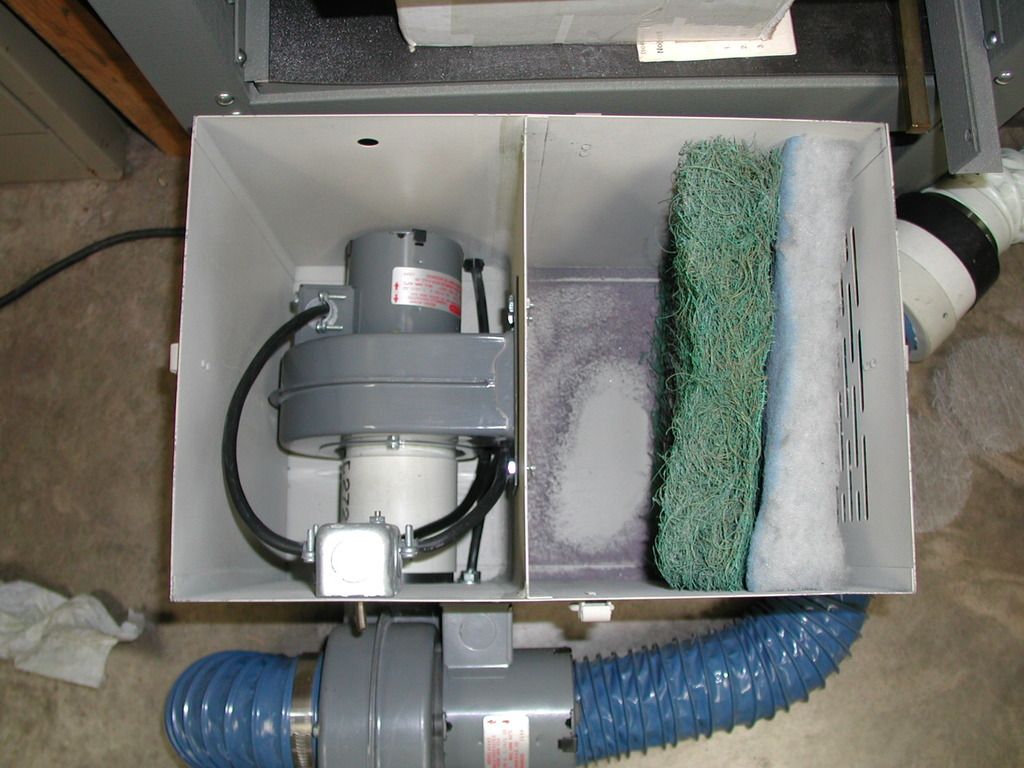

                        It's not a good design for dust since it pulls all the abrasive crap through the squirrel cage blower and the motor bearings eat most of it. It does catch a lot of dust. I made a pre-filter out of some PVC pipe fittings that go in line. There are a couple filter discs that I made out of an old furnace filter. Most of the stuff gets stopped right there.
                        This is what the inside looks like. The remainder of dust that gets past the in line pre-filter stops here.

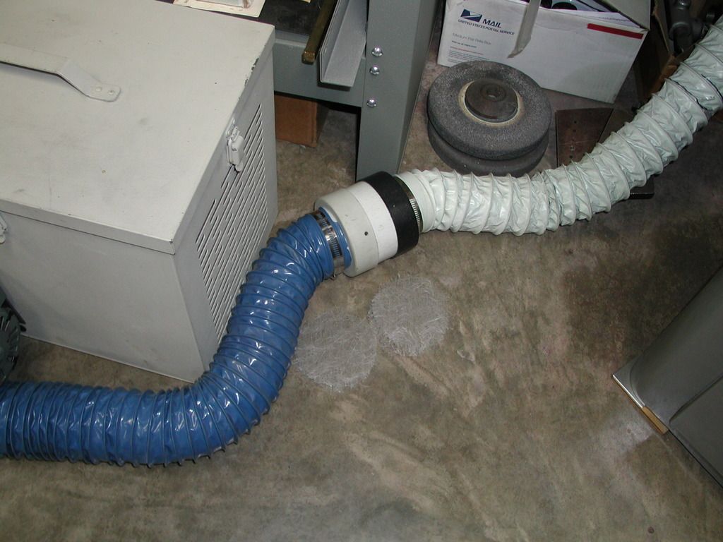

                        Here is the pre-filter. If you look close you can see a couple filter discs sitting on the floor next to it. Those are what I put inside. I think I staked three of them in there.

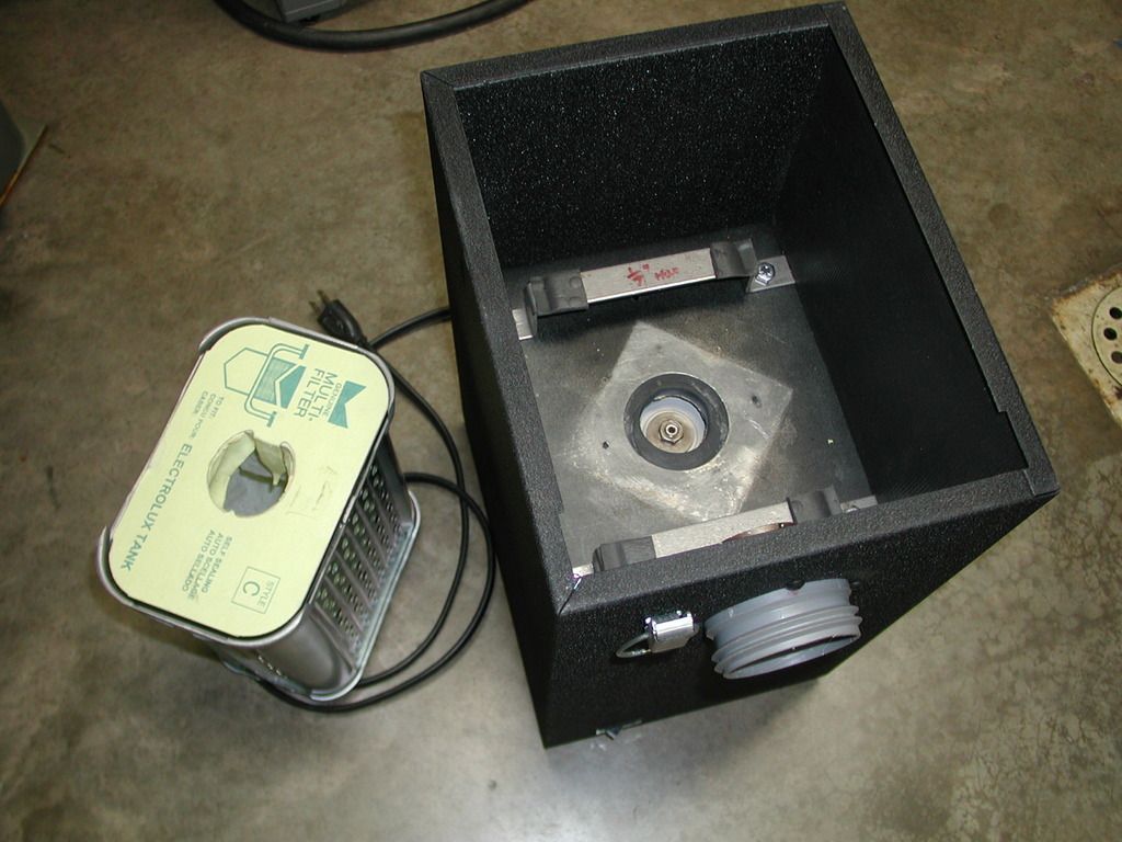

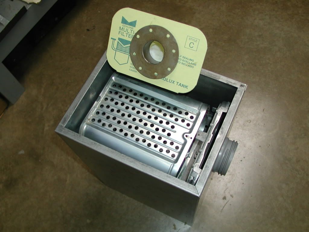

                          This is the other one I've been working on..... for the past 4 years or so. I think this one was one of those dental vacs. It has a real Electrolux motor in it, has good suction. I modified the inside to take a dust bag. I used the bag cage from an old vac and made some mounts for it on the bottom of the compartment.
                          JL..................

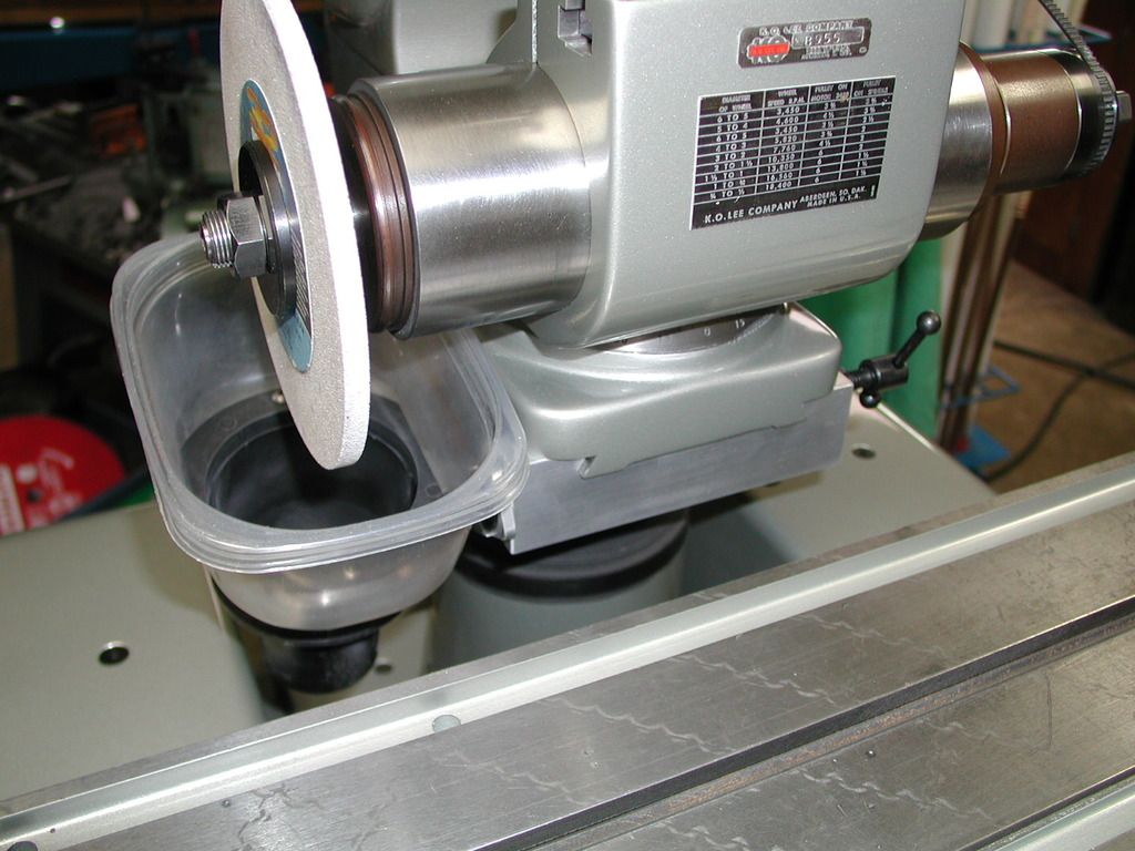

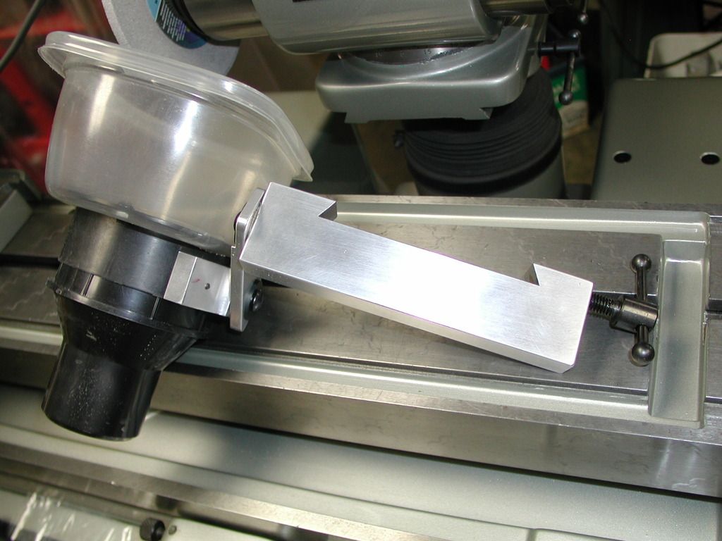

                            This is the mount I made for the T&C grinder. It's a real tight fit as I have little room to fit anything in there.
                            I'm not sire if I'm even going to be able to hook the vac hose up to it.
                            I tried to make the mount as versatile as I could to try and accommodate the various positions of the grinder, but I think there is still going to be a few positions and set ups that I won't be able to use it on. As long as I can dress the wheel into it I wold be happy.
                            JL...................
