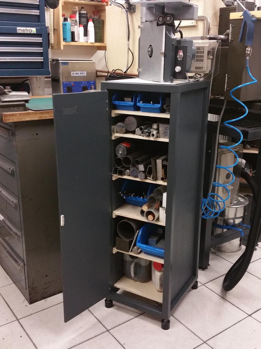

    I grew up in machineshops/prototypeshops that had only vertical bandsaws so I am very used to them and the mindset of using them for a lot of tasks.

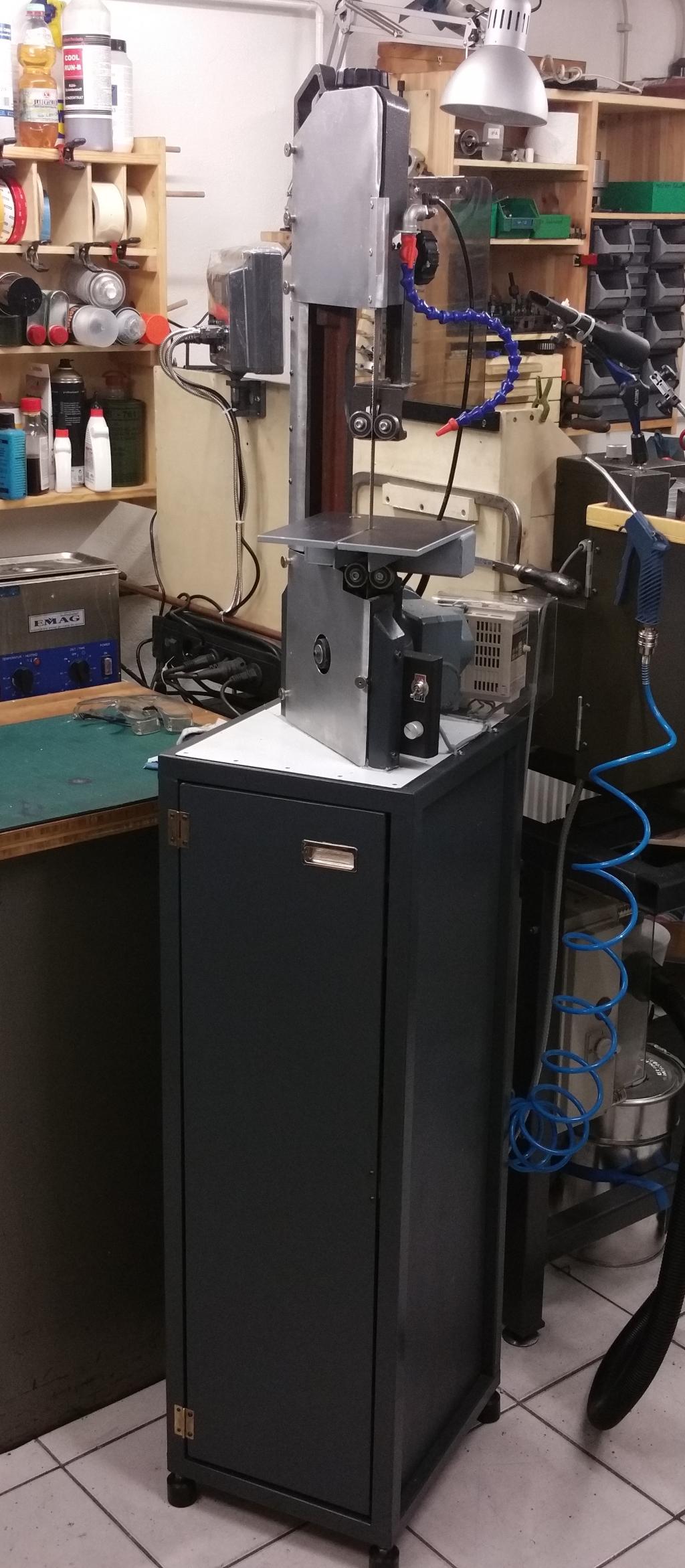

    Of course I have one of the omnipresent 4x6 horizontal bandsaws with vertical capability. When I bought my 4x6 used, it came without the table and thats how I used it for years. Last year I added a sawtable to use it vertical and from that moment on I very rarely used it horizontal, so I decided to ditch the base for horizontal use completely and transform it into a vertical bandsaw only.
    So I welded up a table-frame out of 30x30x2 square steel tubing and mounted the bandsaw without the base onto it:
    Then I added some plywood to form sidewalls, a door and shelfes:
    With all the material in it it sits very stable, despite the tiny footpring of 350x400mm:
    I also removed the annoying 1 phase motor, the belt drive and the original gearbox and fitted a proper industrial 3phase geared motor:

              Nice job on the lower cabinet, too. Band saw a must tool for the shop.

                  I have the 4x6 and use it both ways, but there is the compromise- when using it as a vertical the bed gets in the way of easy use. Many hours I've spent there, canked to one side when I'd rather stand right in front of it. Also the table on mine is small to allow for horizontal use without having to change anything.
                  I'm hoping that my build will overcome more than a few disadvantages of this combo machine- but I can't knock the combo, it has cut a lot of materials for me.
                  Anyway- Stefang that's a nice clean looking machine you got there.
                    Really nice build. Enjoyed the pictures. That is a wet gear box? Looks solid. Umm? Where did you steal that perfect door from? Nice cabinet and your shop, tidy and prolly very fun to work in... Thanks for the tour.

                          I did what Baz mentioned. Made a hinged vertical table that rests on the lower blade support, is clamped in the vise, and has a hinged extension to sit on. Works well, gives a large table for vertical work, provides a comfortable working position, folds up flat for storage, takes about 30 seconds to mount/dismount. Takes about half an hour to make out of MDF. Costs about $5.
