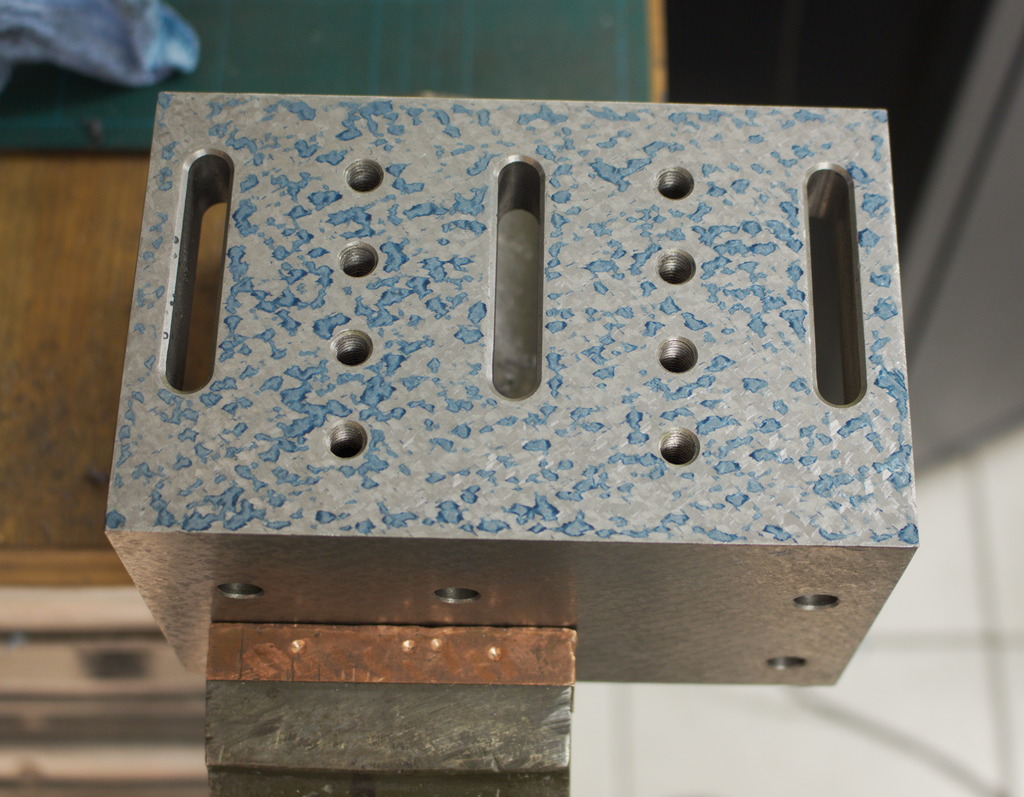

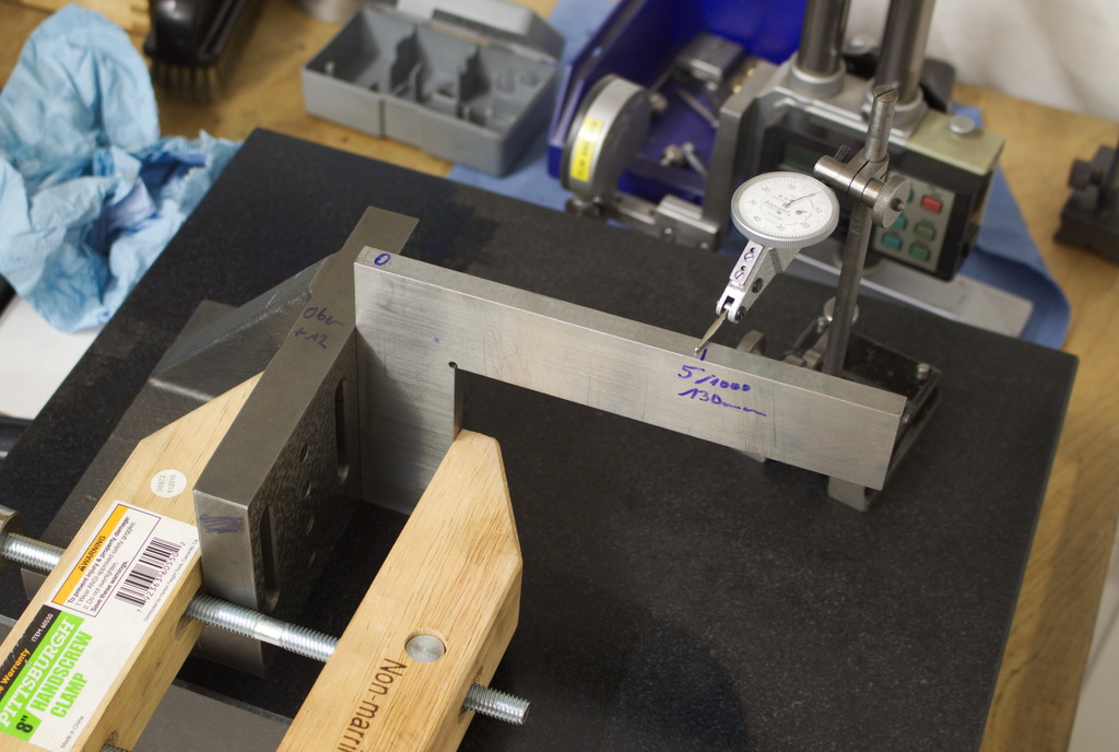

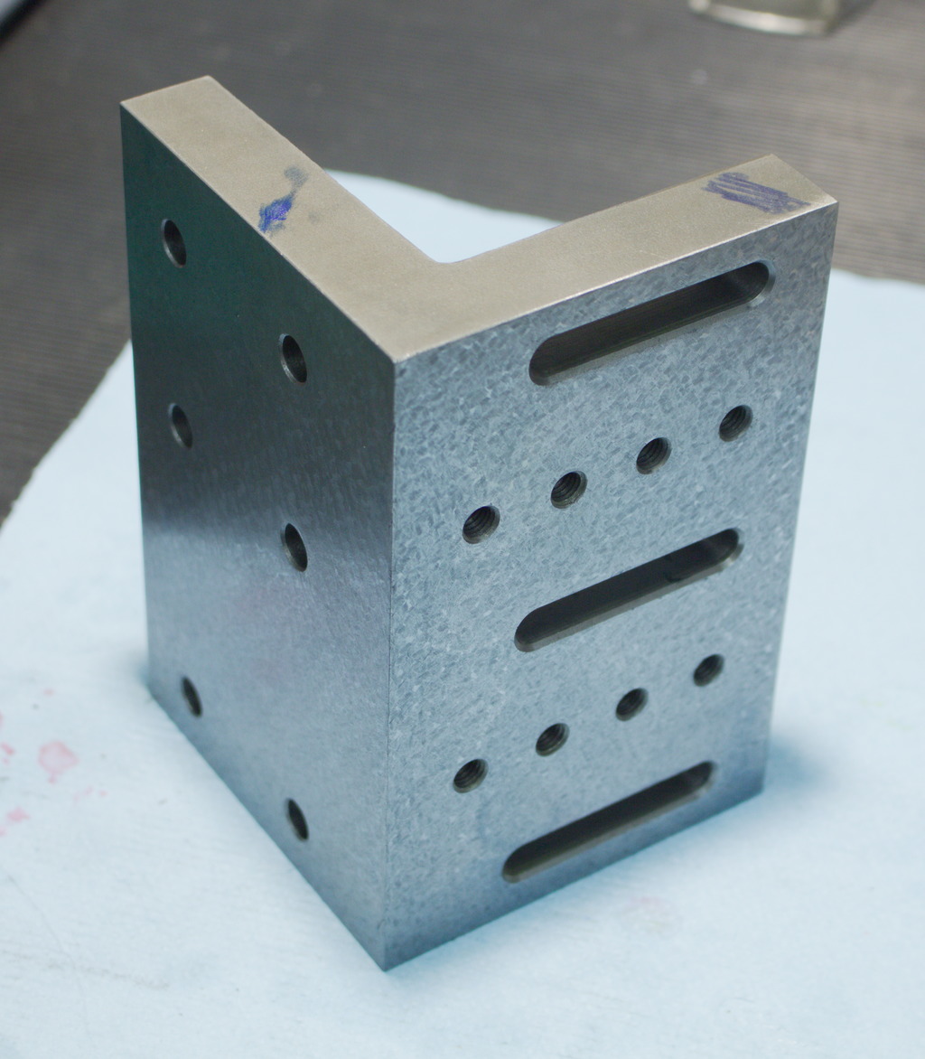

    An angleplate I finished recently, square within 5/100mm over 130mm:

            In your first picture, the angleplate shows many "bullseye" spots. Those are spots where thr center is lighter color than the periphery. They have a definite dark ring around them.
            Those spots are considerably higher than the rest of the surface. And they are higher than the lighter spots which have no dark ring around them.
            It is good to "split" those spots only, to bring them down to match the lighter (and lower) spots. Maybe you finished them later than the picture, I cannot see from the other pictures.
