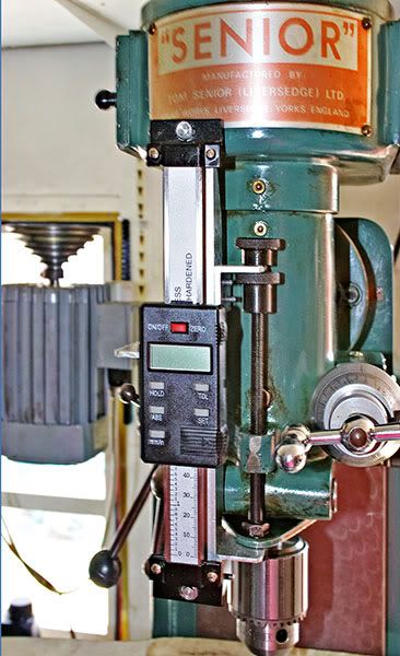

    Added a DRO to the quill and made a speed chart that relates to the VFD drive.
    DRO fitted

              Is that one of the Asian scales?How do you like it,some of the ones I have seen tend to go blank and jump between readings,or maybe I'm just used to my Mitutoyo.

                  I've not put the scale to the test yet,I do know it seems to play catch up when I move the quill.
                  It would seem to be a characteristic of vertical scales.
                  I'm just about to order the "Shumatec" unit that John mentioned a while ago.I can hook my quill unit into that, and I am hoping that it will give a faster reading when connected to a separate display.
                  The scales are all Chinese so time will tell.
                  A few weeks ago my Mitutoyo vernier died and I needed a new one quick so I went to a local tool supply,paid about twice what I would have paid on ebay if I had had any patience.
                  Tha new vernier is not a patch on the Mitutoyo for how it feels,I can't put my finger on what it is exactly but it just does not feel anything like the quality of the Mitutoyo.I frequently find I am reseting zero when I switch it on,it won't be long before I get fed up and get another Mitutoyo.
