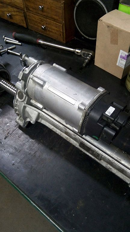

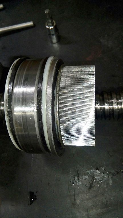

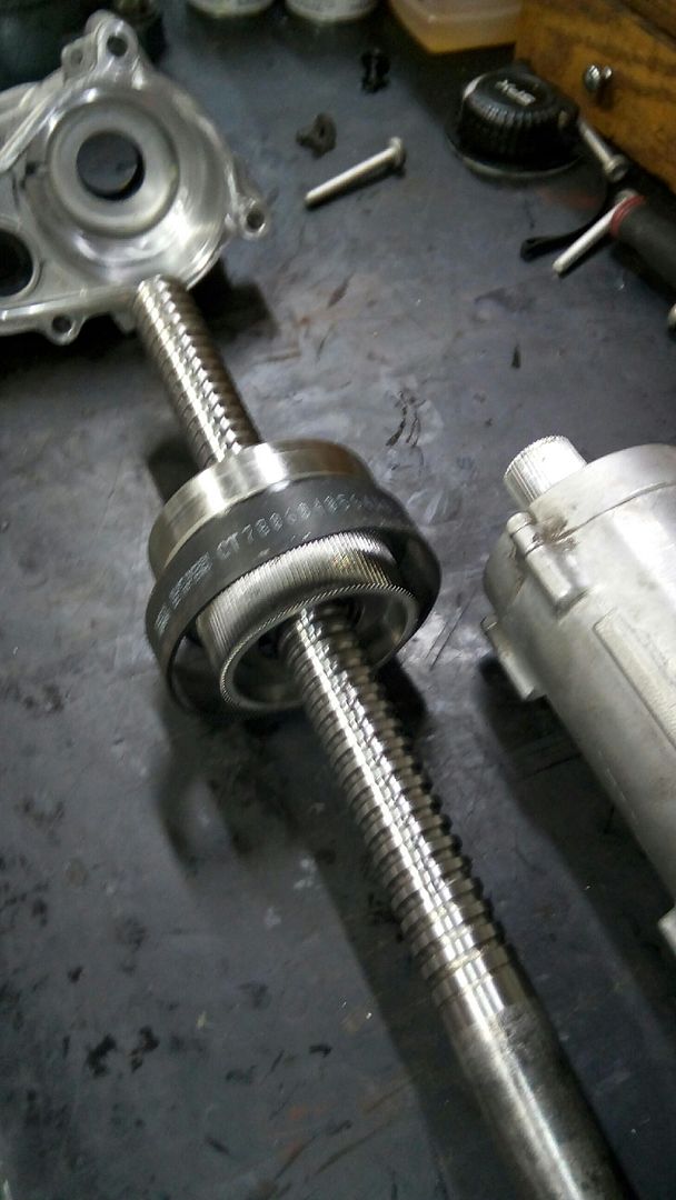

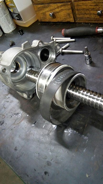

    Finally got one of the electric power steering rack & pinion assy’s out of the scrap box at work to play around with. Quite the serious bit of hardware! It’s got a 28mm x 7mm ballscrew with around 220mm travel, a large preloaded support bearing assy with a 22mm fine pitch toothed drive belt and a huge drive motor. The input pinion unit has an encoder & torque transducer of some sort. With no electrical power it functions as a manual rack & pinion & back-drives the ball-nut & drive motor. When powered up, I theorize that inputs from the input pinion are translated into high-power inputs into the motor/belt/ballnut to assist in pushing the rack back & forth. They work great & the onboard computers & cameras enable the automatic parking stuff that works so well in modern cars. Kinda eerie letting your car perfectly parallel park every time.
    I drug it home & stripped it down thinking that I may be able cut it down to the essentials to use it for a Z-axis drive unit for a CNC project. It would probably have the drive componts fixed & drive the ballscrew up & down connected to the Z-slide assy. I’d have to get the motor pulley off & make it fit a stepper motor though. Looking at the size of the motor harness connections, that thing uses at least 50 amps if not more like 75-100A @ 14 vdc. A CNC servo control for something like that would be hard to find. The diagonal teeth on the drive pulley/belt would make a different one hard to source so I’d just make an adapter to make it fit a NEMA23 or 34 stepper motor.

      Wow that's the finest tooth drive belt iv ever seen and diagonal toothed is a new one to me, lots of neat parts thanks for sharing.
        Thank you for going to the trouble of posting pics of it.

                  Don't assume the current draw - that's load dependent to some degree. Make a great cat door opener. Might end up with a few manx-like cats though
                    You could run it on a lower voltage to reduce the current draw or even put a resistor in series. It could be designed to put more than 10kN at the output which you will most likely not need.
                      Cool. Never seen helical teeth belt.
                      (it appears that even double-helical or herringbone belts exist: https://www.rainbowprecisionproducts...-nrg-eagle-nrg )
                        Nice piece of kit! What vehicle is it off?
                        Ian
                        All of the gear, no idea...

                              As Lakeside53 pointed out current draw would be dependent on load.
                              Would not lowering the voltage increase the current required for the same load.
