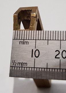

    This is the steady rest with the original brass finger and a bearing screwed onto the end. The bearing is 10mm OD, 5mm ID and 4mm thick. In hindsight I should have got 4mm ID as then the head of a screw would have made good contact with the inner sleeve without a washer.
    If I did go with J Tiers' very sensible suggestion of making a new finger out of steel, I'd have to have some sort of bushing for the shoulder of the screw (left hand side of pic) to rotate in as there's significant transfer of brass onto it even with the little I've used it.
    This is the bushing/axle I made as the dimensions of the brass finger limit the size of a threaded hole to M3
    and this is the result of me cutting a pocket and getting the mounting wrong. I'm hoping that a visualisation of the dimension (assuming a similar size steady rest) may be of help to CCWKen if he's planning to do the same.
    The problem was that it was threaded all the way through - both sides of the finger and the axle. Thought I could get away with it but it (and did a couple of times) but it jacked apart on final reassembly and the brass broke.
    Now, the logical thing to do would be to just screw three bearings onto the sides of the fingers as the original recipe called for. I do like the idea of them being inset though - it just seems 'nicer'. The question is, how should this be done correctly? ...and this really is a search for a better understanding of how bearings and shafts and the like ought to be done rather than just this specific problem.
    I've made the axle 5mm in diameter so that it is a gentle press-fit onto the bearing. I figure I want the bearing to do the work so I don't want it spinning about its axle and it definitely doesn't want to be a sloppy fit. What's the recommended procedure here? Slip-fit and Loctite or press fit?
    The axle I made is Loctite'd in but I suspect some may have got in past the rubber shield as the bearing is a little lumpier than it was.
    The hole through the middle I made threaded. I understand this was part of the problem but if I made it a close-tolerance clearance fit would I not then have problems with the axle spinning about the screw and gouging up the bore on the thread?
    In the simpler 'screwed on the side' method, the screw clamps the axle against the finger so that prevents it turning. With the axle being mounted inside the finger, do you rely on the screw pulling in the sides enough to clamp the axle stationary?
    I realise that there needs to be something making contact with the inner sleeve of the bearing and not the outer race so that the bearing doesn't grind against the metal to the side of it. I made my axle 5mm with a flange 6.5 mm diameter by 0.5mm thick to do this. I think for quicker repeatability (making three of them) it would be easier to just make a 5mm axle and use a washer each side - although I think the thinnest I have is 0.8mm which is beginning to make the sides of the fingers a little thin for comfort. What's the usual method here?

      Planning ahead comes in handy once in a while. Your brass fingers look a little thin or bearings too wide. I wouldn't have cut that much stock out of brass. The slots in the follower they ride in looks capable of handling a much beefier finger. Take advantage of that and make thicker fingers. I think they did that so the follower could go up close to a chuck, face plate or flange with the mounting hardware they had but how often does that occur? (Not sure where your follower mounts in relation to the tool tip.) And there's no rule that says you can't countersink new hardware into the fingers.
      I know you're trying to use parts you have and I've opened a can of worms but stepping back and looking at the big picture can save a lot of frustration.

            Hi Ken. Not a problem opening a can of worms. I have the obvious easy way out if I should chose to take it....but sometimes complicating things can be interesting! And I'm fairly sure I'm going to come across this issue with bearings on shafts at some point in the future so it'd be helpful to understand how not to do it in advance! The double-ended bump tool I have in mind, for example.
            I originally bought as wide a bearing as I could find, thinking it would spread the load out on the part. I could probably make the fingers wider if I made new ones. The securing bolt (black, oval-headed) would stick out proud of the surface but that's not as much of an issue as I originally thought it was - I thought the head needed to engage with the slot to prevent it turning but it's just to clamp the finger in place once adjusted.
            Would probably still have to make them out of brass/bronze to re-use the existing adjustment screws though - unless there's another way I can make a bearing surface for the screw...?
              I think you are worrying too much about the bearing surface of the screw wearing, its probably the screw itself having such a rough finish that it is abrading the brass. Smooth up the surfaces with some fine wet and dry paper or a fine stone/lap.
                You may well be right. Lack of experience makes me look for problems that may not be there....but I'm getting there. Whether I'll have driven you all to insanity before I get to that point is still up for debate!
                  As mentioned by JoeLee earlier, it is important to prevent any chips/swarf from getting in the vicinity of the rollers. A thin piece of plastic the diameter of the steady rest with a hole to just clear the workpiece would do quite well. Save each one used for future jobs and some sticky tape would hold them on the steady.
                  If you make some new fingers, whatever metal they are, make the nose end thicker to give yourself more meat to work with.

                    Will have a go at that. Ordered some 20 x 12mm steel. Should give me another 3mm of thickness to play with and a stronger material. Definitely plan to make the nose a bit longer so I've got more material between the mounting hole and the slot. By my calculations, I should still be able to get 40mm diameter through it or thereabouts. Haven't yet gone over 20mm so doesn't (yet) sound like a limiting factor.
                    Presumably keeping the chips out isn't to protect the bearings - I got the two rubber shielded versions to (hopefully) prevent that. It shouldn't be able to deflect the material that much as the other two contact points should stop it so presumably you get a chip under the roller and it just makes a mess of the surface of your piece? Being that the outer race of the bearing is going to be hardened and therefore 'win'.
                      I believe the concern with chips is getting them between the roller and work.
