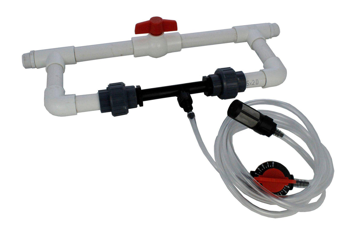

                      first link i could find that shows a picture of how to setup you injector
                      TWSS Venturi Fertiliser Injector Unit Complete is a cost effective complete system offering the best adjustability and ease of use of any type of injection system. PVC Pipe Construction PVC Ball Valve Chemical Resistant UV Resistant Mac Unions For Easy Installation And Removal of The Injector Suction Kit Included 20 mm
                      I have a setup at home exactly as this picture shows - you need to slightly close the "red tap" so that you effectively have a lower pressure at one end; this causes the suction to draw the liquid fertiliser up into the system
                      Works great in my garden sprinkler system
