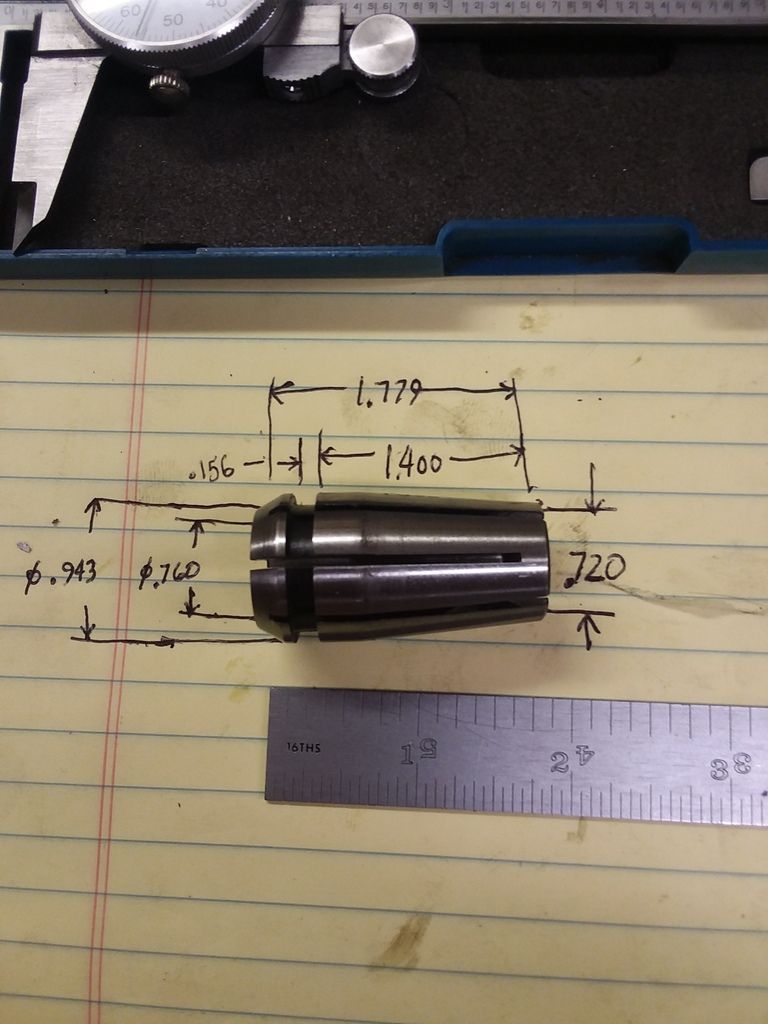

    What kind of collets are these?? They came from harbor freight about 10 years ago. They look like ER collets but the dimensions don't match. The set has 1/8 to 5/8. The 5/8 size is max id that will fit within the outside dimension of the collets. There is a sku number on the case 34730. The overall length is 1.787 inches and the outside diameter at the largest point is .943. Any help would be appreciated. Thanks.
    P.s.pic to follow.
    <a href="http://s194.photobucket.com/user/ahidley/media/20180915_023339_zpsvbpdjneq.jpg.html" target="_blank"><img src="http://i194.photobucket.com/albums/z80/ahidley/20180915_023339_zpsvbpdjneq.jpg" border="0" alt=" photo 20180915_023339_zpsvbpdjneq.jpg"/></a>
    http://i194.photobucket.com/albums/z...psvbpdjneq.jpg

    SK16 ? OZ ?
    http://www.collet.com.tw/en/product-...M-A-CLASS.html
      MattiJ They are a differant shape....
        My bad, couldn't wait for pics..
          Seem like you are not the only one wondering those collets: https://www.homemodelenginemachinist...-collet.16186/
          Orginating from china so they could be some japanese or russian(sovjet) standard.
          TG75 is quite close but not really..
            A poster in that thread pointed to this table: http://www.tools-n-gizmos.com/specs/EOC_Collet.html
            EOC 16 seems to be the closest. Apparently, it's a DIN standard.
              I was already trying to sell OZ collet on first post
              Most sources give the EOC/ OZ16 /DIN 6388 B 415 collet length as 40mm which is quite a bit different from 1,78in (45,2mm)
                Maybe acura flex. I have a bunch if you want me to measure? JR

                            This morning I put one of my collets on the shank of a letter drill that fit it snugly and mounted it in the my lathe chuck.
                            I then measured the angles on the collet with a digital bevel as accurately as I could after zeroing it on the drill shank first.
                            The long taper on the inner end of the collet measured 4.2° and the forward bevel which was not too easy to measure was 29.75°. The diameter at the rear edge of the forward bevel was .943" and the length was 1.786" I was surprised to find that the angles were not that close to even numbers and none of the dimensions come to an even metric dimension either.
                            These collets look very similar to the RDO collets but the dimensions are not the same.
                            Larry - west coast of Canada
