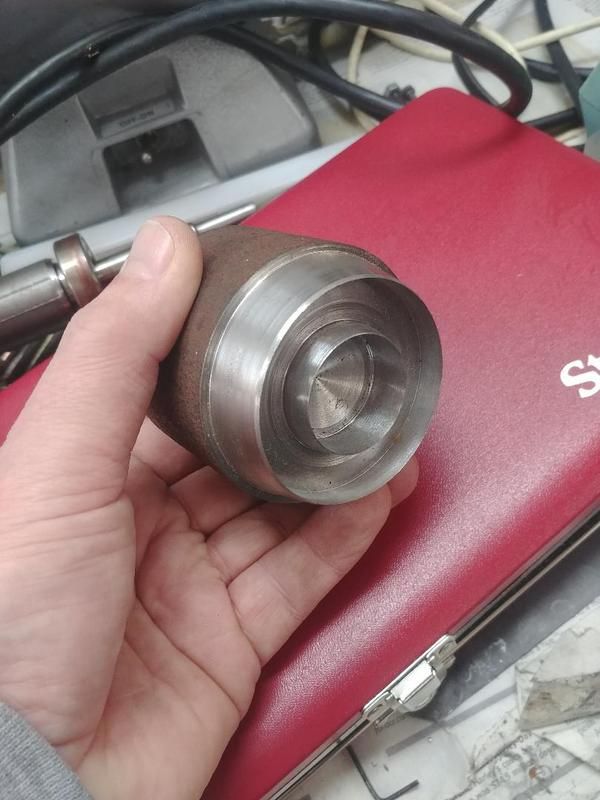

                        Here's mine. Rusty scrap, 10 minutes. For Baldor grinder felt washers. Only $7 each from Baldor + stupid freight, but would have taken a week or two. PhotoSuckit is being slow today... the image will eventually show up, but here the link.

                          That's a good looking 10-minute die!
                          The first time I checked your post, the picture wasn't there so I click on the link. Wow! That's the last time I'll click on a PB link. They start showing me a video of someone's birthday in a couple of window panes. Then on top of that, they want me to allow Flash Player. WTH! The only reason for that must be tracking and stealing my machine time for more ads.
                          • #28
                            It is indeed good looking.
                            An example of what can be done quickly with a machine having some power and rigidity..... Not gonna get that done in a hurry with an Atlas 618, or a 9 x 20 import.
