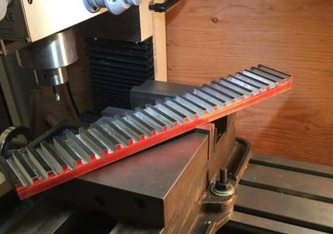

    I hope to use it for milling guards and small folder parts. These are generally small or thin parts, and I don't think mill size or power are going to come into play here. But I have a few other projects I'd like to try on my own, one of which I'll try and outline below;
    I'm trying to make an attachment for my belt grinder. One part requires milling slots into a piece of 6061 (slots are .25 deep, .50 wide, and 2.5" long) I'll post a photo of what a similar piece looked like;
    Are the mills I'm looking at going to be able to have larger projects like this? Are there any particular features, etc that I should look for based on what I'm needing it for?

        There's no scale to your picture so "larger projects like this" means nothing. We all like spending other people's money but get the most you can afford. While you're doing that, you can count on spending 2-3 times that for tooling. Most new-to-the-hobby forget that you need tooling. Without it, it's like buying a car without wheels. Nothing is gong to happen until you have them. But just buy the tooling you need to start and add more as needed. Have fun with what ever you get and be mindful of the hazards that go along with power tools.
          A Seig mini mill in any of the brands would do what you're after from what you're posting. Some of the larger pieces might take a bit longer due to lighter cuts. Especially in steel. But there's no doubt that with patience and time you can certainly do the sort of things you're asking about even for making the slots for the belt grinder parts. If it'll fit within the limits of the table travel and clearance and within the room between the maximum table to spindle distance less room for the cutting tool then you can machine it. The question is how many passes and how light the Depth of Cut (DOC) must be for each pass.
            Sorry, I thought I had included some dimensions. But in this case, it's a 1"×2.5 bar of 6061, and I need to mill slots (.25" deep and .50" wide)
