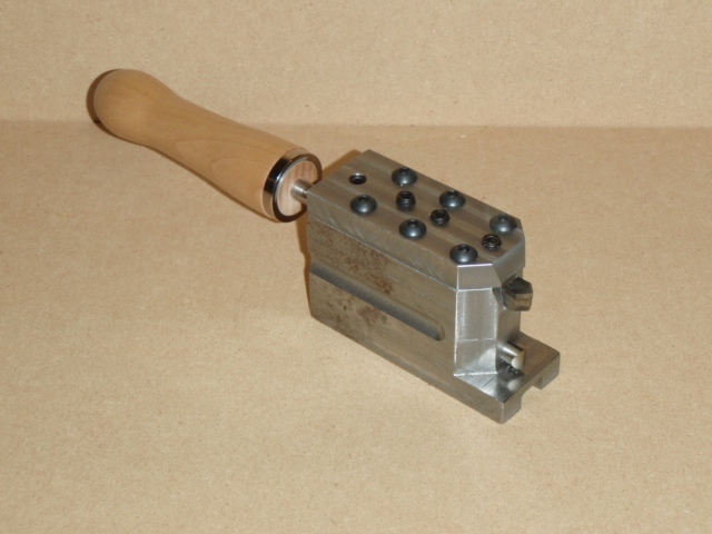

    When I read this thread, http://bbs.homeshopmachinist.net/thr...turning-system I decided that I needed something of this nature, but I wanted something a bit heavier and more robust. And I didn’t really like nor see the need for the pantograph tracer. So after a bit of pondering and conjuring, I built this:

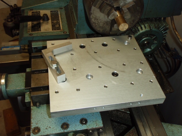

    This plate bolts to the cross slide of my lathe and has an array of 1/4-20 holes to accept a pivot pin and various motion limiting stops that I made. Note the pivot pin in the corner near the motor.
    A “radius bar” fits into a groove at the bottom of the tool and controls the curvature of the cut.
    I can do concave and convex radius cuts.

      I made a setting device to set the cutting radius reasonably precisely. Here I’m setting it to 4” concave:
      And here it is at 2” convex radius. The surface that the cutting bit is against is equal to 0” on the rule. The cap screw keeps the cutting edge back behind the end of the “foot” and that make the tool stable. Below the cap screw is a template follower. For template work, I align the cutting tool and follower against the setting surface.
      For template work, the cutting tool and the follower must be ground to the same radius and aligned vertically.
      I’m not using the pantograph system of the “Turnado” tool. I made a holder to align the template directly below the workpiece. I think this will work better by eliminating any inevitable looseness in the panto pivots. The drawback to this method is that it somewhat limits the max diameter of my workpiece. Here is the template holder mounted on the table

                            Here's a better pic of the cutter/follower arrangement. Note that the template is about 5/8" above the table. On the tool itself, the follower protrudes from the front of the body, directly below the cutter. The follower is held in place by a brass machine screw.
                            And note that both the cutter and the follower are about 3/16" behind the front of the foot, so that the downforce from cutting keeps the whole rig stable.
