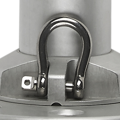

    This is the drum for the roller furler on my friends sailboat:
    He ask me to make a tool for installing and removing the shackle pin since there's no room to get your fingers in there:

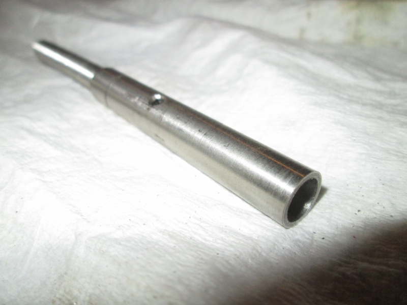

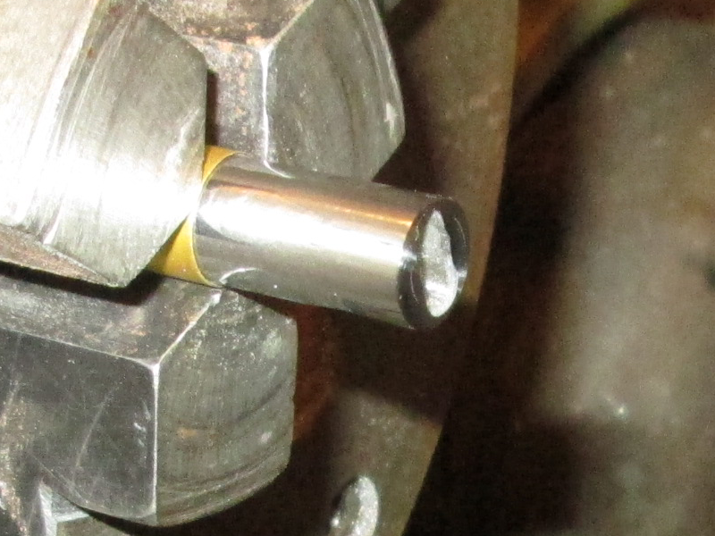

    I started with this piece of stainless. The near end is counter bored from when I needed to make some washers. The blurry end is
    threaded 5/16-18:

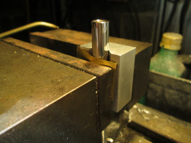

    After polishing it up, I mounted it vertically using an aluminum V block and a piece of brass shim:

    Then I milled a slot in the end to engage the flat end of the shackle pin:
    Another view of the end:

                Interesting though, but it's still buried pretty tight in a corner:
                Even if we found one that fits, it would probably still be awkward to remove.

                      We would still need a tool to snug and loosen it. Besides, there are a couple more shackles of that size and style between the boom and the traveler
                      that will benefit from this tool.
