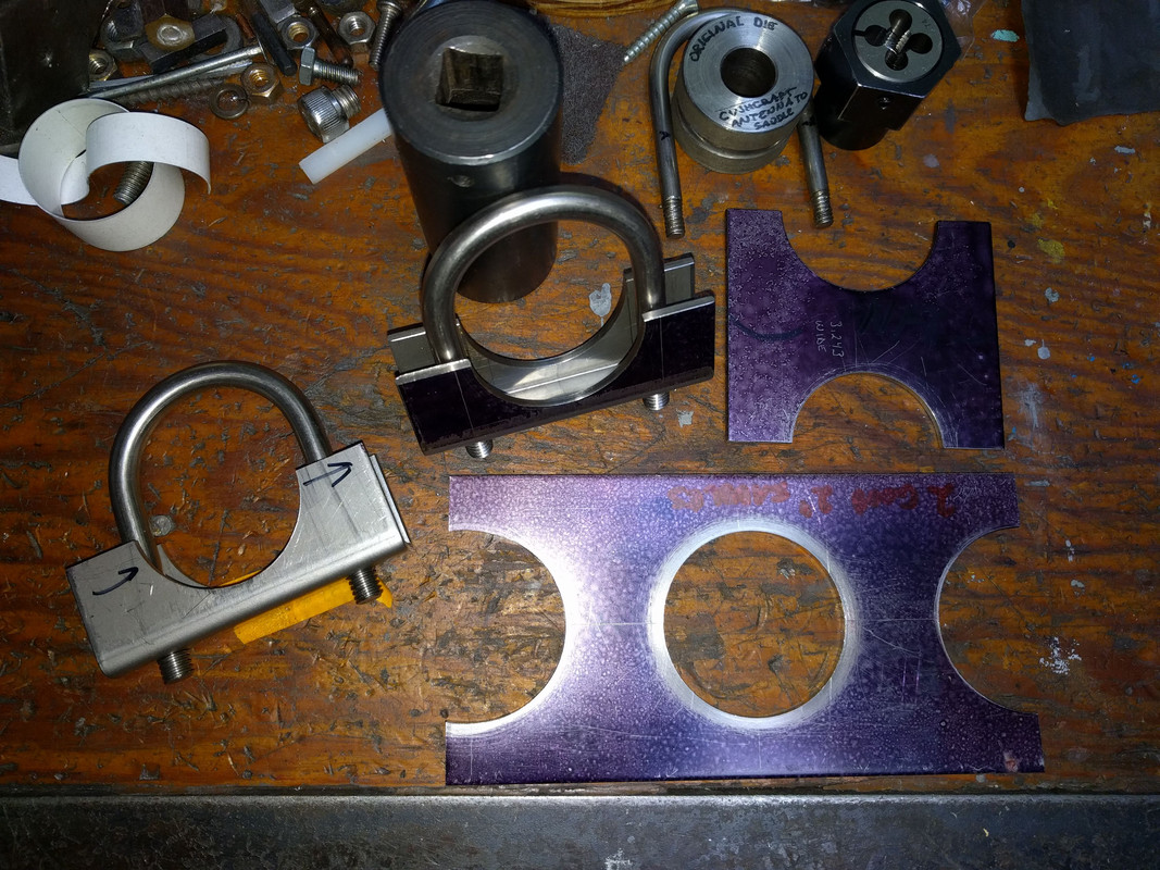

    I have a few strips of stainless sheet, 12ga. .109. I had the strips sheared at 3 1/2" in width. I should have specified 3 1/4"
    Anyway, I've set some of the pieces up on my mill after I cut them to length and used a slitting saw to trim them, but that's pretty time consuming.
    So If I were to make a shear, a short one that could cut perhaps 6" in length and set up an edge guide and a way to hold the piece down, how much force is needed to shear this stuff?

            I don't need to make many of these right now, maybe about 6 of them for various size U-bolt saddles. The width of 3 1/4" is the same for all as shown in my picture.
            I do have a bandsaw but it doesn't make a good finish cut. The shear makes a nice smooth rolled off edge on the cut. I would like a shear fixture for future use and fast accurate cuts with good repeatability.
            Layout is very important when I hole saw and dill the holes. Off a few thou and when the clamp is formed the circles won't line up perfectly and the saddle won't sit square on the tube.
            Just trying to think ahead here.
            JL................
