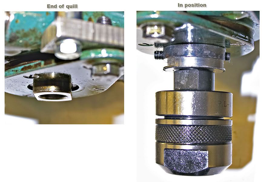

    I got fed up clouting the draw bar to get my #2 morse taper tooling out of the quill on my mill,so I made this split nut arrangement to fit on the bottom of the quill.
    No marks for finish but it works.Threads are 26 tpi and the whole thing is 1/2" deep.

            That's a great idea and great work. Now you have me thinking about making one for my Myford spindle which will enable me to remove the milling arbor without wacking the end of the drawbar - and will act as spindle thread protector at the same time.
              Guero,
              That's what gave me the idea.
              I've had one of those on my Dore-Westbury mill since I built it because it has a Myford thread on the nose.
              Mine is just a thick threaded ring with holes in the outside for a piece of 5/16" bar to be used as a lever.
              Allan

                  Ben 78, just looking at the pictures it appears the upper ring is fixed to the spindle nose & when one wants to break the taper, get a spanner and turn the bottom part of the ring which is threaded into the upper part and it pushes on the shoulder of the tool. I suspect you only need a little movement to break the taper hold. A very good idea I must say. It must be that Daylight Saving thing you fellows over East have changed to that is causing memory loss.
