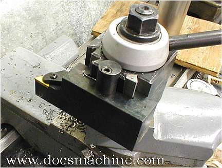

    In between other work (we all know how that goes) I managed to finish up one of the carbide-insert toolblocks:
    Again, because the tool height is fixed because of the insert, I made a fixed stop, rather than an adjustable thumbwheel.
    My teach at the college gave me a handful of lightly-used but still servicible inserts, in a variety of styles, and so I made the holder to take any common 3/8" IC triangular TPG, TPGB or TPU type insert.
    I have ten or twelve plain TPG, uncoated, and the clamp seems to hold 'em pretty securely. It's hard to see, but there's a thin wall on the forward edge, so two sides of the insert are supported. Also note that the clamp has a slight indexing notch in the radius at the base of the main body of the block- this locks the clamp to keep it from twisting off the insert.
    I'm going to duplicate this one with a mirror-image nose, for facing, but I have two more rough-milled to make a similar turning block. What inserts or style should I make 'em? Suggestions?

      Third pic:
      The clamping bar is flat, but the notch at the back end (towards the block) is slightly raised by a few thou, allowing the bar to lever down and contact only the insert (which is itself a thou or three higher than the surrounding steel.)
      I also wanted to point out I added a few degrees of rake to the insert- the pocket floor is a few degrees off level with the block/post. I probably won't be able to use the zero-rake double-sided inserts, but that's okay. The plain TPGs are plentiful enough.

              Nice job!Have you tried to see how hard you can push an insert yet?
                Hey Doc, nice job. What "blackening, bluing, browning" method did you use please? JRouche
                  GreenWilly- (have you had that checked?) It's my understanding that double-sided inserts are zero-rake, and the pockets of the holders are milled at a negative rake (tilted towards the workpiece.)
                  So if you want to use double-sided inserts and/or have an application for negative-rake machining, then yes, just cut to seat appropriately. I'm definitely no expert, but it seems 10 degrees of negative rake would be excessive.
                  wierd- Not yet. I tried an .030" pass on a stub of rusty steel (I think it used to be a big truck wheel stud) and it didn't complain a bit. I tried a quickie .050" pass on a hunk of scrap aluminum and the finish came out very nice.
                  My lathe only has a 3/4 HP motor, and a somewhat-slippy flat-belt drive, so I suspect the belt will give before I overpower the grip of the insert. At absolute worst, I could use both the center screw and the clamp on a center-hole insert. I imagine that'd take more HP than three of my lathes can produce.
                  JRouche- It's "gun blue", a liquid prep you can get at most gun-accessories retailers, as well as (I think) places like K-Mart or Wal-Mart (if they have a gun/sporting goods/reloading section.) It's a bottle of a bluish fluid, wipe it on clean, carefully-degreased steel, and it almost instantly turns a deep blue-black. Oil it heavily afterward to "seal" it and stop the process (which is akin to rust) and bring out the gloss.
                  It's not as smooth as real gun blue, nor as durable, but it's cheap, simple, and easy to touch up if necessary.
                  Only reason I did it was so the blocks wouldn't rust from fingerprints, and would more or less match the stock toolpost blocks. It's very close, actually.
                  Doc.

                      GWP; i buy a lot of inserts from the local 'tool by the pound' guy. these are used and surplus tools that come from some aircraft factory. the inserts i get are of all dfferent kinds and shapes. i have made lots of toolholders for them. i have found that about 7* of rake is what works best with negative rake inserts. it doesn't seem to matter much what shape the insert is. i realize this ain't scientific, but the lathe i am using them on is a generic chinese 14x40 that has been worked over enough to be pretty tight. i still like positive rake inserts better. the necative rake ones kind of rub the metal off and the positive ones *cut*. i cut the pockets for positive rake inserts flat, or at 0*. parallel with the plane of the toolholder.
                      i have noticed some negative rake toolholders in catalogs with an 11* pocket for the insert, but have never used anything like that. it seems like a lot of rake to me.
