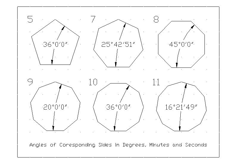

    Smokedaddy this is for you. If tou haven't researched anything on 5C collets go to the Hardinge Work Holding website and peruse the catalog http://www.hardinge.com/usr/pdf/collet/2348.pdf The wide range of tooling, fixtures and workholding solutions for 5C collets has made them almost universal for a lot of applications. While they are not perfect they are extremely versitile. One of the uses is in the common 4 and 6 sided collet blocks. Another is in index and dividing heads. But for odd sided collet blocks you have to make your own. I have never seen them commercially available. One thing you need to know if making you own odd sided is the angle between the coresponding sides that you are indexing off of
    As theCAD drawing above suggests some odd sided blocks are sore readily made than others. The Ageless Engine people actually suggest that some one building one of their engines start with the 9 cylinder as it is easier to set up the parts for machining

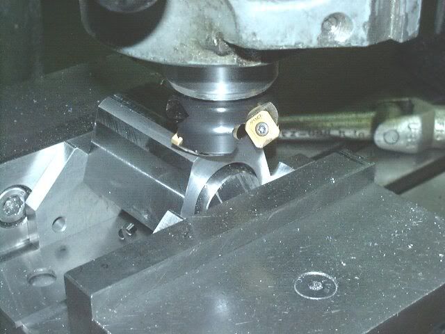

    The two 45D angle blocks are the resting surface for the 1.250" diameter bar stock. Also shown are a machined 5 sided block and a blank. In the mill the set up for the first side is as shown
    After this side is milled (we want around 1" finished dimension to the centerline) it is indexed so that the machined surface is postitioned up against a 36D solid angle

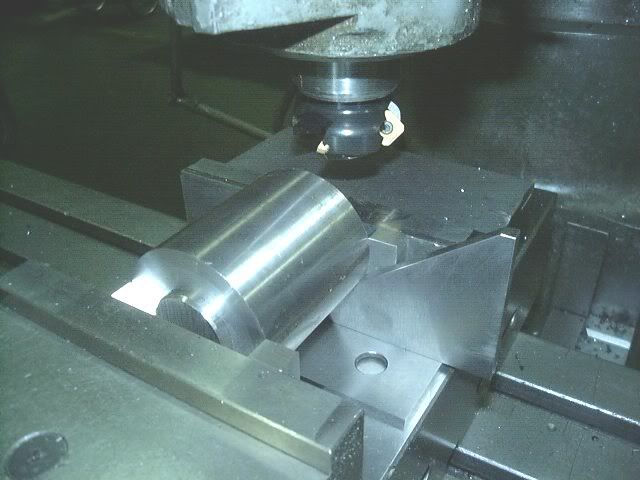

    Machine this surface to the same dimension as the first and index so the surfac you just machined is againt the solid angle. This is the last surface.
    After the main surfaces are machined and everything is deburred place the block on one of the surfaces and take a cut to break the corner

      The blanks were made out of 4140 Shafting (35RC) material from a shaft that got relace in one of our filtration units at work. When they replace a shaft I'll cut up the old one for projects.
      The bore is 1.250 which is the body size for 5C collets. Other collet sizes have different dimensions. The Hardinge catalog should ahve all of the major collet types listed
      The round stock acts as a locator for the blocks so all of the cuts are made with the centerline of the bore at the same height
      The 45D solid angles are something that I made up along with a variety of other angles (30,25, 20, 15) There are comercial versions out there but I'm cheap.
      To measure from the flats one could use a dpth micrometer or the head end of a dial caliper. For this I just cranked the mill's knee up to the same number on the dial. Each side wa three cuts. Two of .100 and one of .050"
