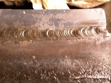

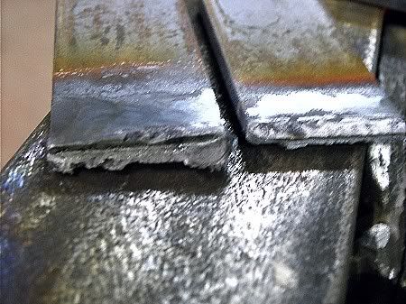

                      May as well post some welding stuff here. Was pretty interesting..
                      My "TOO" large welding tip... hard to handle but I'm getting the hang of it.
                      A few restarts that aren't great due to short pieces of coathanger..ouch!!!
                      I gotta take a new pic of this in the morning...it turned out as nice as wirefeed..

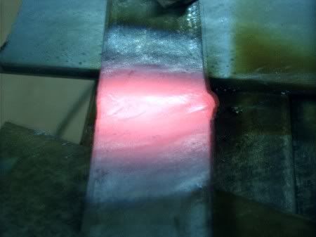

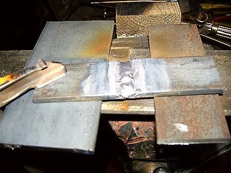

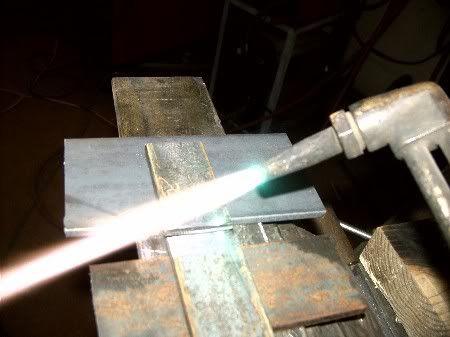

                      NOW.. welding with a cutting torch... This will be fun...

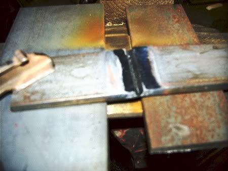

                      Hmmm ...doesn't look THAT bad... but "Houston...we have a problem"
                      • #41
                        Flip it over and back gouge it...
                        OMG.. this is hot! Only 1/4" material...very hard to weld fast enough with the torch..
                        The problem.. as I was welding it I could see that the high gas pressure from the torch was "sucking" dirty air into weld from under the flame. The weld wasn't pure...it was sorta frothy. All in all... it didn't look too bad considering..

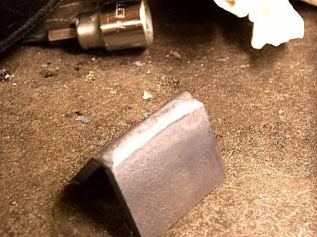

                        Bend test... failed.. you can see the frosty weld broke..
                        However.. this wasn't a proper test. I never waited for the coupon to cool, the anvil on the press was very sharp and the female die was too short...compared to a proper tester..
                        So.. I'd like to try this again, with a smaller tip. I'm also going to do some more testing with the coathangers...maybe a problem but I don't think so..
