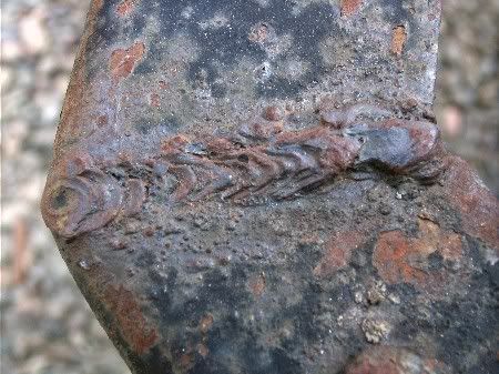

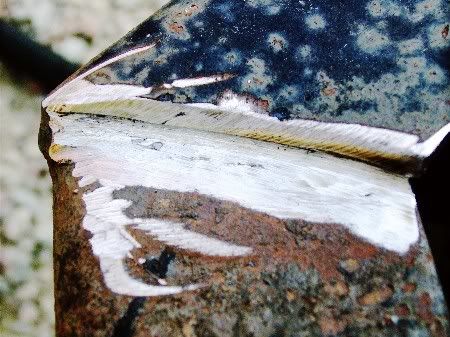

                              Here's one for you..."Problems from our shop"...er.. i guess it's just me now...lol!
                              Guy brings in this ugly old homemade trailer.. I "strongly" suggested maybe i reweld some of the more critical welds... can any one spot why...lol!
                              Oh boy.. the deeper you dig...

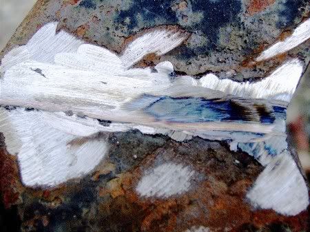

                              See the blue spots? That's where someone just "slopped" weld on...there is no fusion under the blue spots..

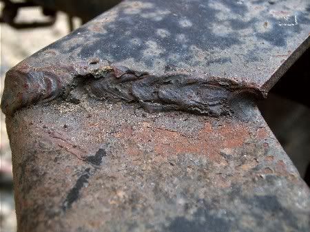

                              Notice the little wee blue spot and several small inclusions. This was just plain ugly about halfway down...still needs a little more grinding
