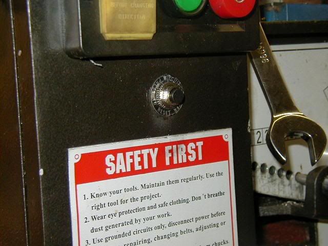

    Well, I took off from work long enough this morning to remove the old fuse holder and install the circuit breaker. Turned some teflon to use as a bushing in the fuse holder hole so that the breaker would tighten up. Everything is working good so far. But then I haven't gone back to turning steel yet either. We'll see.....
    • Fixed
      Well, the breaker fixed the problem. Turning steel again with no problems. Now, if I can just stay off this computer long enough to get something done in the shop. Cold as a witches tit out there now. I think I'll stay in tonite.
      • pictures please
        Hey There HSS. could you post some pics of your new breaker set up? I'd love to see how you did it. Just in case......
        • Reg, I took 2 pictures tonite of the breaker. One of the front of the breaker and one of the back. The back is covered by the power cords and can't see much. It's an easy conversion, just a tight location. The breaker had flag connections but I soldered them instead. I used a set of hemostats as a heat sink when soldering so that I wouldn't overheat the breaker.
          The picture below has a 1/2 inch tall black box above the cord on the right. That is the back of the breaker and it nearly touches the metal control cover on the back. I used the insulator off of the old fuse holder to put between the back of the breaker and the control cover.
          Pat
